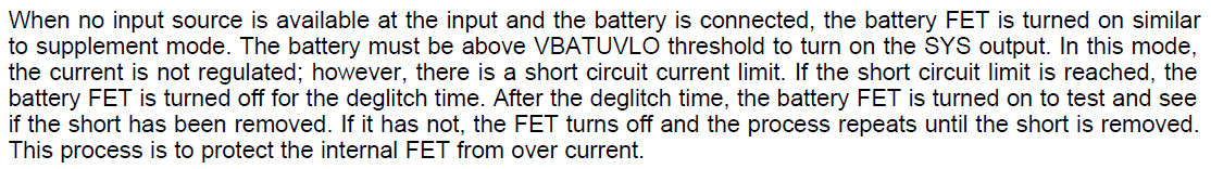

If I set the /CE bit in the Register #2 according to the the datasheet, the charge function is disabled by turning off the BAT FET between SYS and BAT. What happens, if in this situation the adapter is removed? Does the bq24253 recognize this and connect the battery to the load before the voltage of the load drops too much? Or is this simply a reset?
