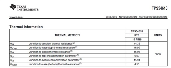

TPS54618 θJctop = 46.09°C/W
That TPS54318 Theta JT number is actually Psi JT not Theta JT. If you compare the Psi JT numbers it is 1 C/W for TPS54318 and 0.9 C/W for TPS54618. TPS54618 has the latest thermal modeling numbers, only Theta JA is based on the same conditions as the TPS54318 thermal data.
I show Psi JT to be 0.9 C/W for TPS54618. I can look tomorrow if there are updated parameters for TPS54318.
yJT Junction-to-top characterization parameter |
0.9 |

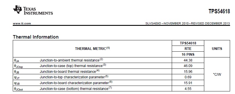

The datasheet I have is different. It looks like the thermal parameters are revised, so 0.69 C/W is correct.
From the thermal modeling site:
description |
TPS54318RTE |
Result- Theta JA-High K (standard datasheet value) |
49.9 |
Result-Theta JC, top (standard datasheet value) |
52.4 |
Result-Theta JB (standard datasheet value) |
22.8 |
Result- Psi JT (standard datasheet value) |
0.8 |
Result- Psi JB (standard datasheet value) |
22.8 |
Result-Theta JC, bottom (standard datasheet value) |
8.1 |
Modelling Assumptions |
C/W |
