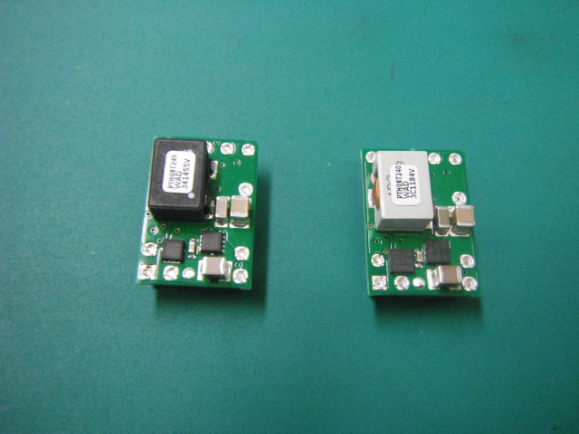

PTH08T240WAD Package Color question
Dear All
Thi is Makino from Marubun in Japan.
Could you tell me the about PTH08T240WAD package color.
It was delivered with a black package until now. However, packages of gray  was delivered only 1 pcs.
Black package and gray package is same performance??
Please send me a black package and gray package performance is same's evidence sheet.
Best Regards.
Marubun Corporation
SALES Dept.1
Shoji Makino
TEL+81-3-6381-7901
FAX+81-3-3661-7471
e-mail
shoji_makino@marubun.co.jp
From Makino(Marubun)
  • The power modules including the PTH08T240Wxx have always been fully qualified and  approved for dual source power inductors.
    There is no change in form fit or function when using either power inductor source. The mechanical and electrical characteristics are equal when using either power inductor.
