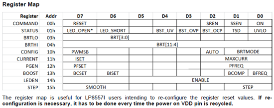

I think there are 2 choices to reset all registers of LP8557I.
One is to write RESET bit(0x00h D7) and the other is to recycle VDD(Power on reset).
Is there any difference in the state of device after these reset?
My customer concerned about that, so your support would be appreciate.
