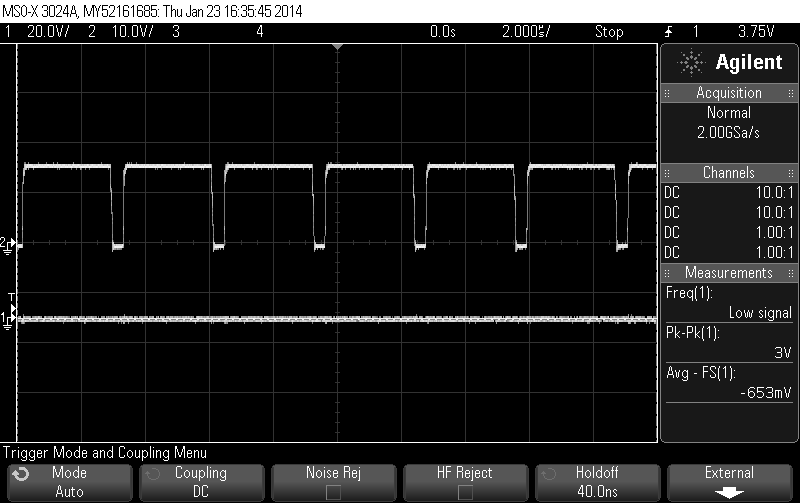

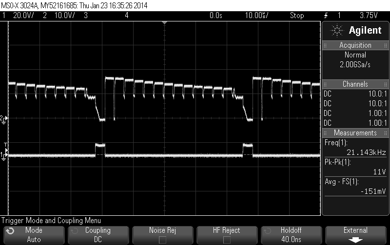

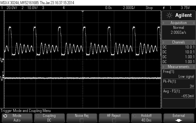

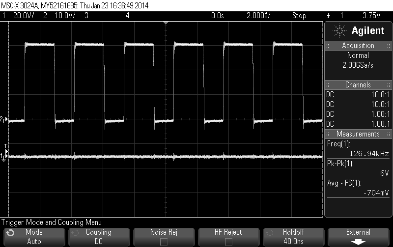

  • These are the waveforms of the mosfet gates, the upper one is the High-side gate, the lower one is the low-side gate:
    input 8V, no load (output around 8)
    input 8V, 1A load (output around 6)
    input 20V, no load (output 12)
    input 20V, 1A load (output 12)
