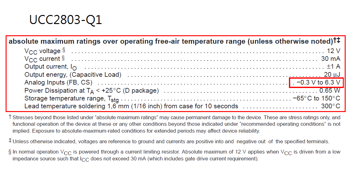

I'v checked Maximum rating of Comp. But The datasheet doesn't describe it.
What is the maximum rating of COMP Pin? Hope to see prompt answer.

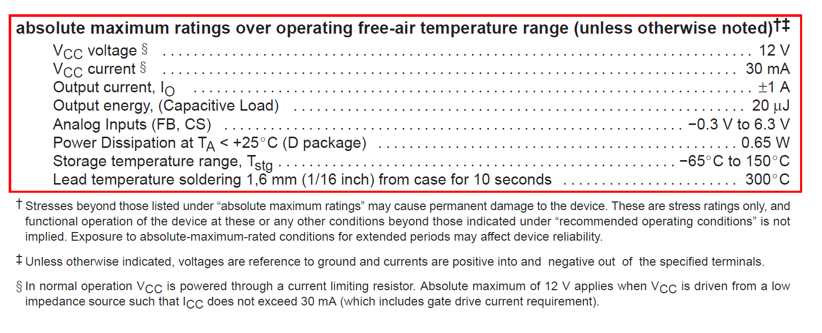

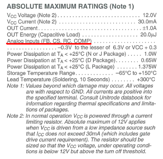

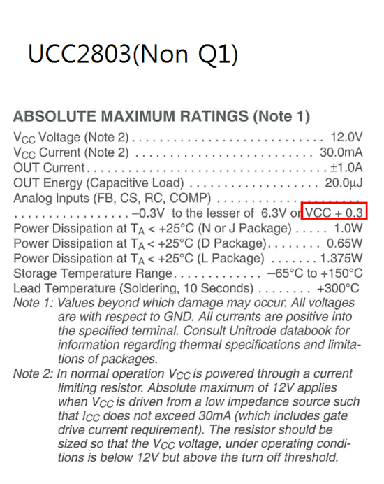

Hello Jake
The Abs Max rating on the COMP pin is " -0.3V to the lesser of 6.3V or VCC + 0.3V" You will find this on Page 2 of the Datasheet (below) , although I admit it's well hidden and I understand how you missed it. Regards
Colin
Jake
Here is the section from the Datasheet that I should have attached to my previous post.

Hello Jake,
My apologies for the delay in answering.
I queried this with one of our design engineers and he replied -
"COMP is output which generally are not rated with old devices since it is determined by the supply of Error Amplifier.. COMP’s abs max rating is most likely of REF+0.3V, i.e. 5.3V."
Is this answer ok for you?
