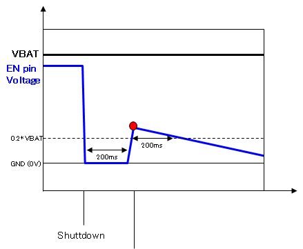

Hi
The EN pin of the our customer's circuit works as follows.
Over shoot does not exceed VIH level.
Don't the TPS61020 work on a red point? Disable?

Hi Pan
to make sure that EN is logic high or low, the EN voltage should be higher than 0.8*Vbat or lower than 0.2*Vbat. the EN logic is not sure if the voltage is between this two value. so the device maybe turn on, or maybe not, depend on the voltage of red point. thanks
