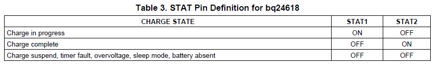

Hello Li,
Most of the single cell chargers have a /CHG pin which is low impedance during the charge cycle which can sink current through an LED to indicate the battery is charging.
A simple solution would be to look at the BQ24618 which has two STAT pins that are used in the following way to indicating charging and charge complete.
