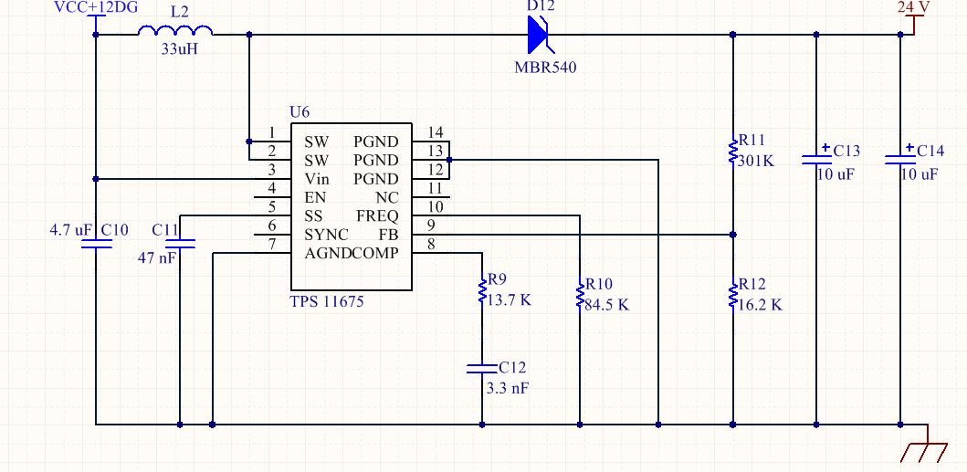

i have used WEB Bench to design a DC to DC converting circuit using the tool
i have used the part no TPS61175PWPR
my input is 10 volts to 18 volt and taking out put from it is 24 volt 100 mA
 and i  get a design from web bench . i have did a layout and mounted all parts as specified in design but i m not getting OUT PUT..
MY circuit out put is 11.94 volts only
please help
