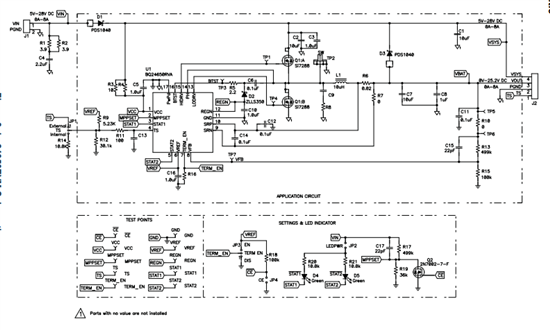

    I have designed the circuitry of MPPT charge controller using BQ24650 (the EVM circuit) .  I am facing the problem that the battery does not charge through this circuit. The main problem being that I am not getting the desired voltage of 12.6Vdc at the Vout pin. Can you please suggest me the solution to this problem?
    Thanks and Regards,
  • please send the schematic.
  • Respected sir,
    I have attached the schematic of the circuit with this post. Kindly guide me through the problem. The circuit is taken from the application circuit document 'sluu444a' of BQ24650.
    Thanks and Regards,
  • What is the voltage on the MPPT pin?
    What is the input voltage?
