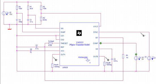

is it possible to control the frequency (150kHz-500kHz) and the duty-cycle (0-80%) of the LM5025? Can I use the SYNC-Pin for this? When I use the SYNC-Pin in PSpice the outputs are low (0V).
My circuit with synchronization:
Tobias

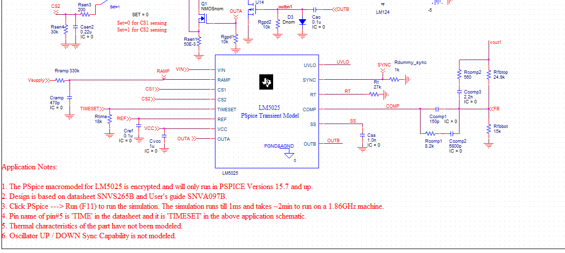

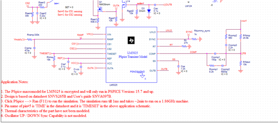

  • Hi Tobias,
    The SYNC PIN functionality has not been modeled in PSpice model you are using. It is mentioned in the application notes section of the PSpice model under 6 as shown in the below image.
    Thanks and regards,
    Irappa
