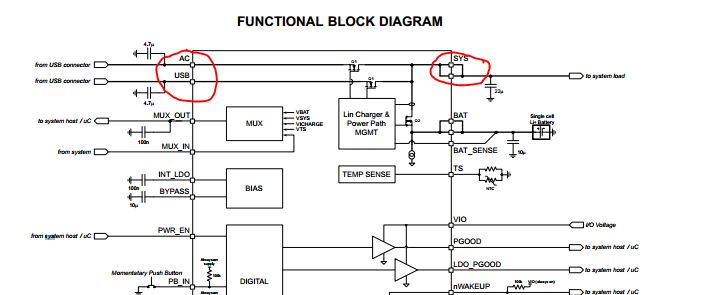

Is it possible to connect the USB and AC input pins to increase the current capabilities of the SYS output?
This is not possible. Only one input is enabled by the power path at a time, so tying the pins together will have no effect.
