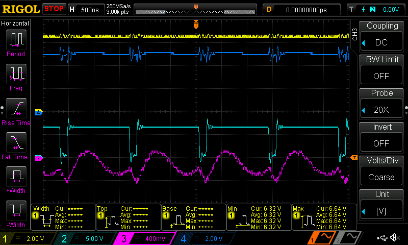

    So, I changed the components I described on the last post, except for the diode (still at 2A). Plus, notice I change the inductor for 15uH see the link : http://docs-europe.electrocomponents.com/webdocs/0fe1/0900766b80fe1f3e.pdf
    The good new, there is an amelioration : between 6.5V and 7.8V, the output signal has less noise as before.
    The bad ones : the output signal is still not stabilised at 6V and with a load the tension still collapse.
    First, 6.5 Vin and unload

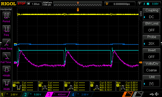

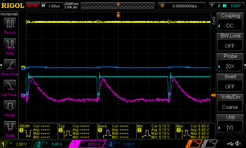

    second, 6Vin with load (warning period changes)
  • Hello Oliver,
    I am having difficulty understanding the 6V waveforms with load when you say the output tension collapses.  Could you label the wavforms?   If the output collapes the FB pin should follow to a low level and the PFET switch should conduct 100% of the time.  This will increase the current in the inductor until current limit threshold is reached.  The current limit circuit will turn off the PFET for a time which is dependent on Vin and FB votlage as described in the datasheet.   If you ar ereaching current limit, then the Radj resistor can be increased.
  • OK,
    for the labels, look at the right you have the different 0V references:
    Vin (CH1) and Vout (CH4) are superimposed
    Vpgate (CH2) and Iinductor (CH3) are superimposed too. (CH3 has a differential probe)
    Otherwise, I already understood how the device works, but no matter, thanks to confirm what I thought.
     So you advice me to increase the value of Radj ? As I said at the beginning of the topic I changed the initial value (2.55kΩ) for the same rated in the evalutation board (2.05kΩ).
