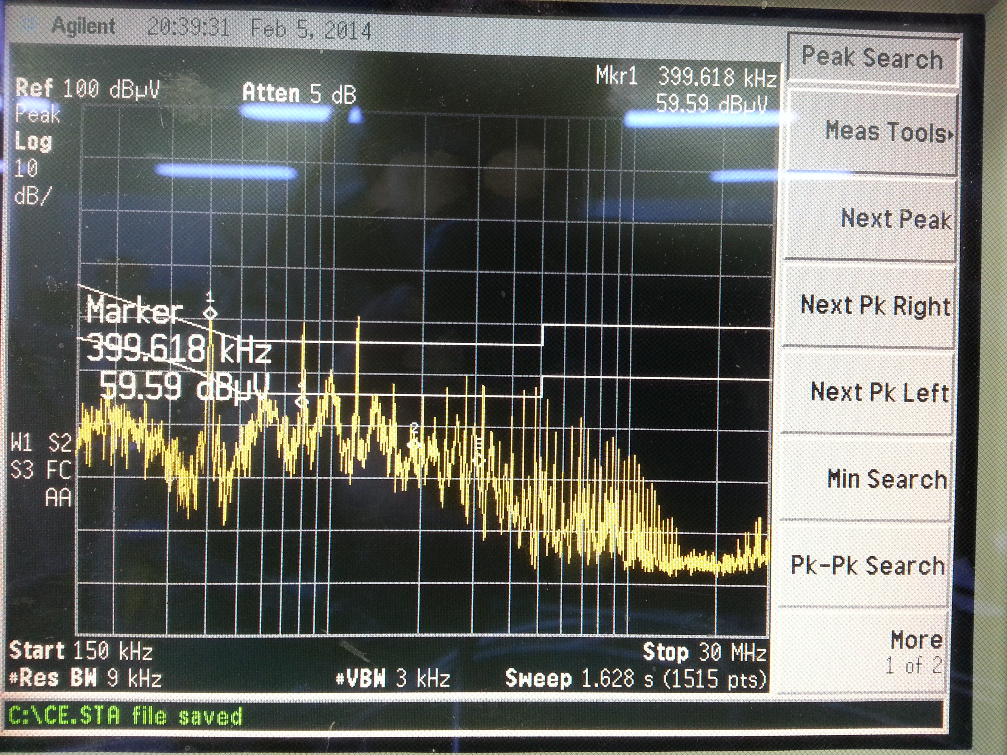

Our customer using LM3488 device and doing EMC(Conducted Emission) now.
Our customer did measure Conducted Emission. Test Result is Fail about switching frequency.
Our customer want solution that reduce 400khz switching frequency
First Solution : Switching frequency reduction of device itself
Second Solution : PCB Artwork method and BPF design of DC input line and so on
Please recommend solution as soon as possible.
  • Hi Jayden,
    For input filter design guidelines and tips, please refer to App note AN-2162
    http://www.ti.com/lit/an/snva489c/snva489c.pdf
    In particular please checkout page 6 of the App Note, section titles: "Damping Capacitor".
    Also an RC snubber across the catch diode will probably help.

    Our customer found solution to reduce switching noise.
    If see attached schematic, our customer did add C37(10nF) to FB line.
    When applying C37, Do not have a problem with the normal operation?
