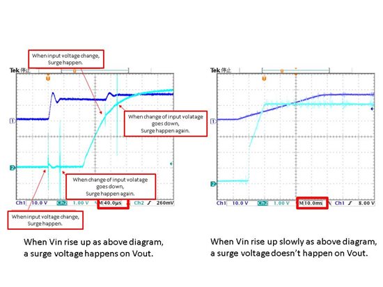

Please let me ask you about TPS79850QDGNRQ1 because I was asked by my customer.
When we input following wave to TPS79850QDGNRQ1,
a surge voltage happens?
Peripheral circuit is following.
Best regards.
