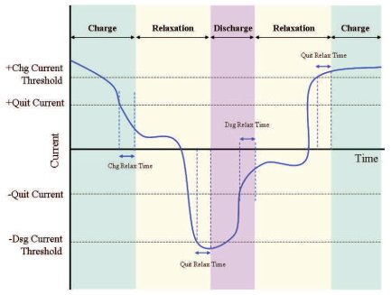

    I think the default settings are actually fine for your application.  The Technical Reference Manual of bq27421 is being updated because the units are incorrect for Dsg Current Threshold, Chg Current Threshold, and Quit Current.  The actual units are 0.1hr.  This means that the default Dsg Current Threshold setting of 167 represents C/16.7.  So if your Design Capacity is 220mAh, the gauge will actually be using 220mAh/16.7hr=13mA for the Dsg Current Threshold.  Since your idle mode current is 30mA, the gauge will leave the coulomb counter on and stay in Normal mode to track this passed charge.

    For bq27421, Chg Current Threshold, Dsg Current Threshold, and Quit Current units are 0.1 Hr rate.
    So, 100 for Chg Current means C/10.
    The units of Sleep Current are mA.
    A1:  You should adjust all thresholds to suit your battery and system needs.
    A2: Quit Current defaults to 250, which means C/25.
    A3: The DSG bit only means current is greater than Dsg Current Threshold.  It has nothing to do with being in Charge mode, Discharge mode, or Relax mode, as defined in SLUA450.
    Small amounts of missed passed charge are okay, since the IT algorithm will use the voltage to update SOC in those cases.

    As shown in SLUA450, there is always (Dsg relax time (60s for 27421), Chg relax time (60s for 27421), Quit relax time (1s for 27421)), which is like hysteresis between the entry-exit of different modes, after respective THRESHOLDs are exceeded.
    However I find inconsistency between:
    1. DSG = Discharging detected. True when set. (in 4.4 Flags( ): 0x06/0x07 of SLUUAC5)
    2. and “The DSG bit only means current is greater than Dsg Current Threshold”
    (1) suggests that Flags.DSG is like “state indicator”, so it changed after “Dsg Current Threshold” is exceeded for longer than “Dsg Relax time”, so hysteresis is included.
    (2) What you suggested directly contradicts the above, and seems to mean that Flags.Dsg toggles instantly once “Dsg Current Threshold” is exceeded. If this being true, then if we have actual load current nominally equal “Dsg Current Threshold”, and has some ripple of 1KHz, then following the interpretation of  your statement Flags.DSG also toggles at 1KHz. Isn’t it questionable?
