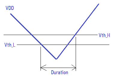

I'd like to ask about TPS65132B.
I think TPS65132B doesn't have Power On Reset and the default value is loaded by IVR in power-up sequence(~20us).
(datasheet P.26)
Startup option: At power-up, the value contained in the IVR is loaded into the volatile DR and IVR presets the
DAC to the last stored setting within less than 20 μs. The programmed factory value of the IVR of each address
is described below and, at power-up, these data byte set the output voltage of each rail.

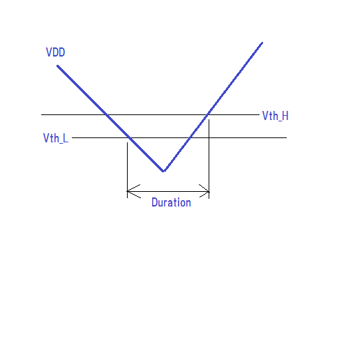

My customer concern if the default value could be loaded involuntarily when VIN decreases instantaneously.
So I want to know the value Vth_L, Vth_H and Duration time that the IVR is reloaded into DR.
Could you give me the value of these?
Yaita / Japan disty
  • Hello Yaita-san,
    The default values of the IVR can be reprogrammed by your customer. So when the customer changes the IVR to the values he wants to have as default, I think he does not need to fear a input voltage drop.
    The only situation where he needs to make sure that the input voltage is not droping is the short time when he reprograms the IVR from the DR.
    Brigitte
  • Hello Brigitte-san.
    Thank you for your quick reply!
    I see, you got a point there.
    I appreciate for your support.
    Yaita
