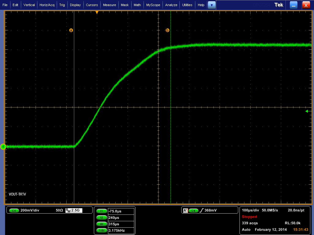

Is there anything wrong if SS time is out of recommend range?
Because TPS54318 rise time wave had some distortions.
ThereforeI tried to shorten the SS time and disappear some distortion.
Figure.1 is before change the SS time
Figure.2 is after change the SS time.

  • I did not see any specific limitations to the SS time in teh datasheet.  In general, these circuits are designed for SS time from about 1 to 20 msec.  It is acceptable to go a little slower or faster.  WWith faster SS times, you have t be careful about current limit.  The dc current required during SS, not including the load current is I = Cout x Vout / tss.  So the charge current for the output capacitors is inversely proportional to the SS time.  For TPS54318 you may get some non linearities as you observe.  At first it is due to minimum on time, then there is frequency shift further up the slope in 3 places.  Decreasing the SS time allows you to transition thru those areas faster so they are less noticeable.
