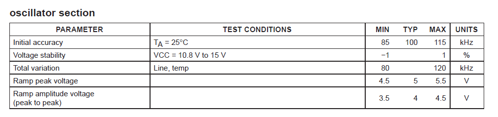

  • Hello Jim,
    Looking through the datasheet on the first page it states that the frequency can range from 6kHz - 220kHz which appears to be referring PWM frequency range.
    The oscillator frequency runs in a constant range of frequencies detailed on Pg. 4 of the data seen in the snippet below.
    The PWM frequency is variable based on the interaction of the oscillator and CLK signals going into the PWM latch which is determined by the resistor and capacitor values attached to RT and CT.
