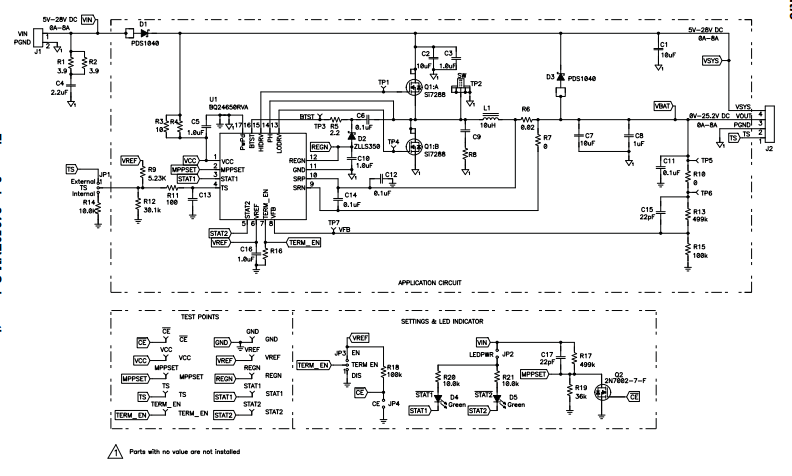

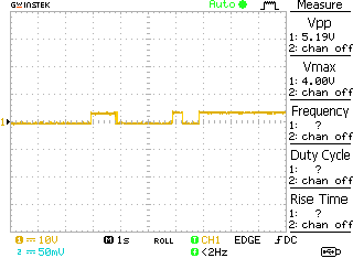

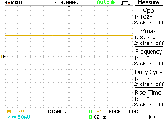

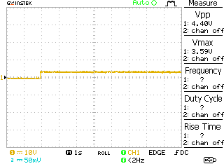

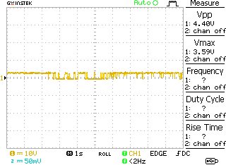

I have built the circuitry of BQ24650 Li-ion battery charge controller by referring to the article sluu - 444a. The output of this module consists of 2 pins namely :
System Out Voltage and Battery out Voltage.

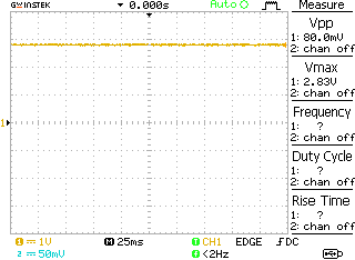

I am receiving the correct output at the system out voltage pin which has to be according to the input supply provided. But I am not getting the output at the battery out pin. The voltage at this pin should be 12.6 Vdc (as per the design) .

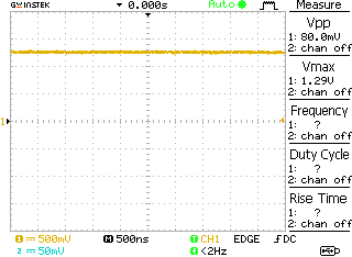

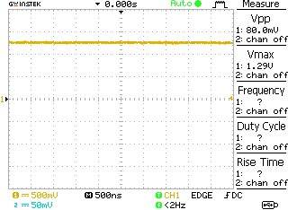

Also I am not getting the voltage at the MPPSET pin which has to be 2.1 Vdc minimum. I have tested all the components and they are working fine. Kindly help me out with this problem.
