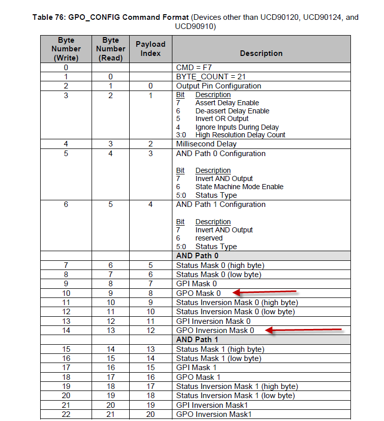

  • I import the configuration to the device using the project file (2133.UCD90120A @ Address 101 Project..xml) that you provide, when I read the GPO_CONFIG for GPO #7 (WriteByte code = 0xF7, value = 0x06; then follow by ReadBlock code = 0xF8), I get back the configuration for the GPO #7 (GPIO14, Pin #29, name = AllGood) as:
    66000000130000007F0000007F0000000000000000
    Byte[8] and byte[12] are for GPO mask and GPO Inversion mask for AND PATH 0 (UCD90XX PMBus Command Reference), according to the config, GPO 7 is set to depend on itself => that is why the logic is not reliable (GPO config should not rely on itself for logic output)
    Change the GPO_CONFIG for GPO7 to 0x66000000000000001F0000001F0000000000000000
