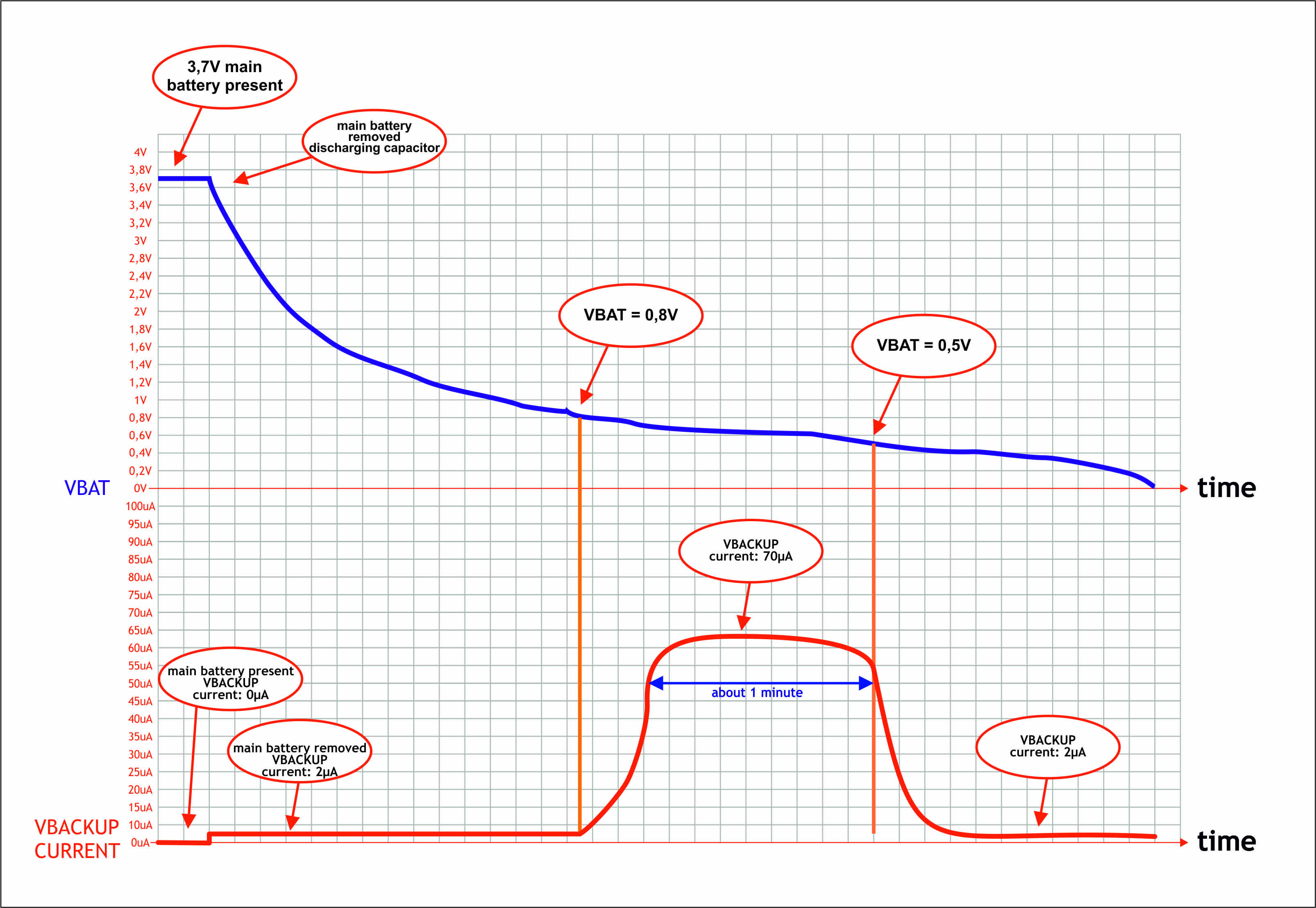

We use Torpedo DM3730 SOM from LOGICPD.
We measure backup battery current, typically 2uA.
But sometimes (during every main battery connect - disconnect state) more than 50uA for about 50seconds.
50uA current is not good for my li-ion coin battery life.
How can i fix this problem?
In this case:
Backup Battery pin is directly connected to rechargeable Li-ion coin battery. (without capacitor)
PWRON pin is connected to button. Button is not pressed. (Pin is float.)
Main Power source is not connected.
VBACKUP = 3.0 V, BBCHEN = 1, BBISEL = 00

  • Ok, so at least there is no external power consumption coming from this node as it is always on. How do you measure this 50uA current: is there a serial resistor with the backup battery? If so, would it be possible to look at the current waveform?
    Best regards, Alain.
  • Ok, so there is something sinking a steady current for about 1mn while VBAT is between 0.8V and 0.5V; at device level the only block which is seeing power is VRTC so you are certain that there is nothing else but a capacitor on this node: no pull-up resistors, no connection to anywhere else? One thing you may try is to discharge the VBAT node when battery is unplugged to see whether parasitic current is still present or not i.e. it is not linked to something else. I guess it won't change but just to be certain. Would it be possible to see your schematic around TPS65950 only?

    If i discharge the VBAT manually when battery is unplugged; backup battery current is always 2uA. This solution is ok. But i can't do it, my PCB is complete. I can't add any mosfet...

  • Yes, I understand schematic cannot be changed: I just wanted to be sure the extra power consumption is due to the discharge of the main battery, nothihg else. So this is verified now, thank you!
    One possibility would be that an internal block is still seeing some power and somehow continues to work, likely because LDO output capacitors are discharged slower than VBAT itself. VINTDIG.OUT, VINTANA1.OUT and VINTANA2.OUT would be good candidates for this. If you could probe them that may help I think.

    I measure VINTDIG.OUT, VINTANA1.OUT, VINTANA2.OUT voltages; these pins voltage is 0V when i plug and unplug main battery. Because disable STARTON_VBAT  bit  on CFG_PX_TRANSITION.
    In this case continue same problem when BACKUP to WAIT-ON state ---> WAIT-ON to BACKUP transition state.

  • Well, this is a tricky question as since there is no supply anymore it is difficult to add any comparator or something similar to discharge the main battery capacitors. One possibility would be to add a serial resistor to the backup battery, not too big to prevent voltage dropping too much but enough to possibly reduce the 70uA leakage. Something like few Kohms should do so I think. Is it something you could try out?
