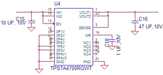

TPS7A4700RGWT Not Regulating

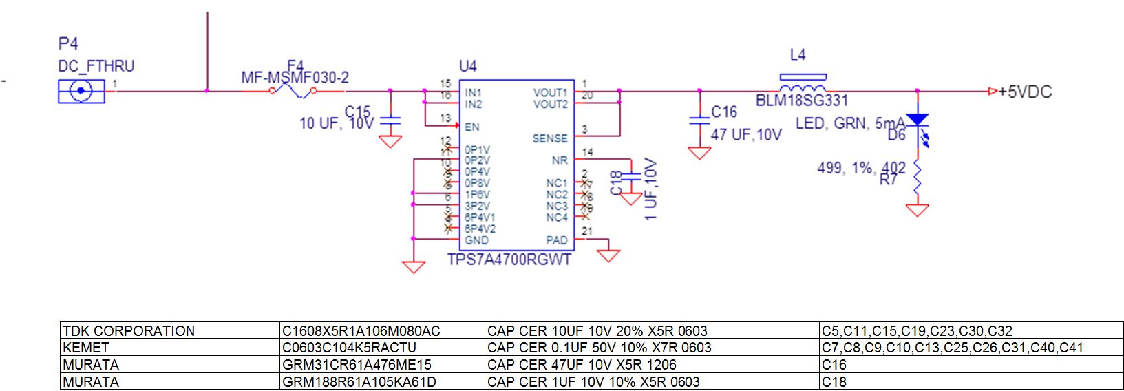

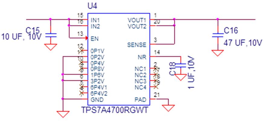

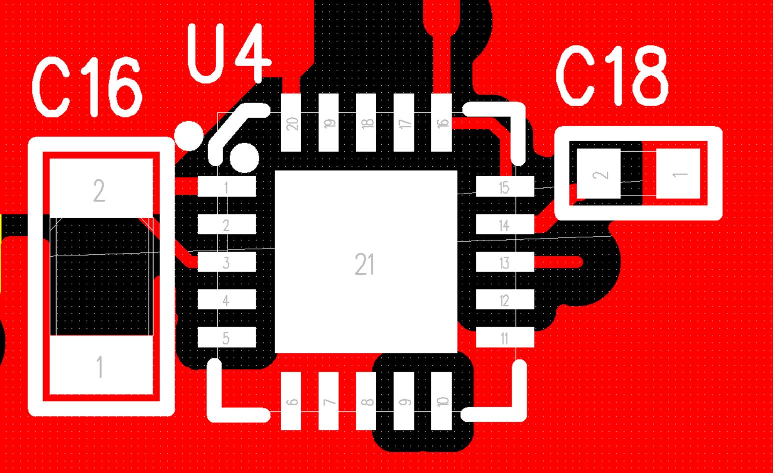

Using the TPS7A4700RGWT, the output voltage follows the input voltage minus a couple of hundred millivolts.  There is no regulation what so ever.    I changed the input voltage from 6 to 8 volts, and the output followed the input.  The circuit was designed for low noise, 5V regulation
