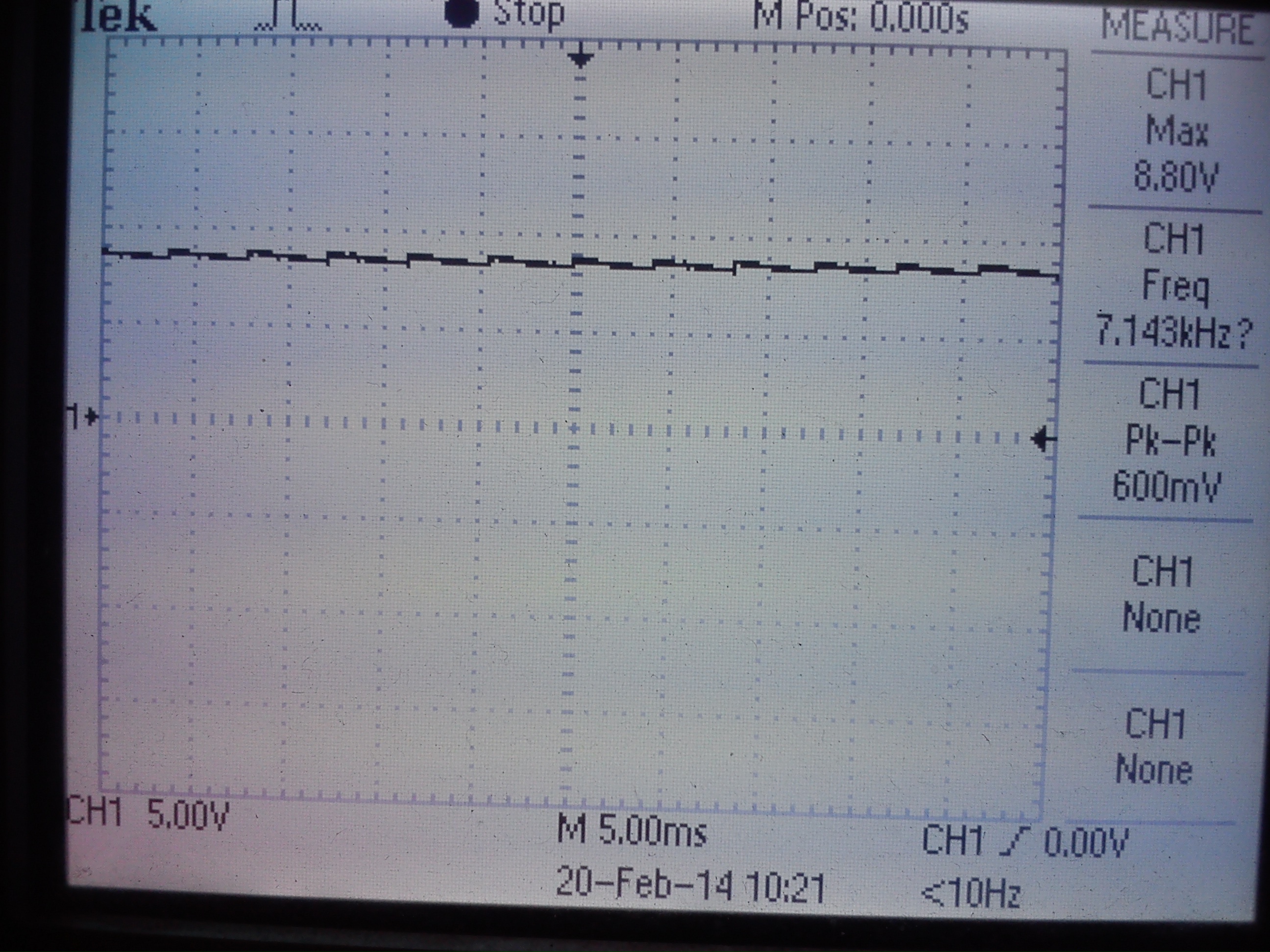

HI Sir,
 I am Using Bq2057 chargemanagement circuit to charge my 7.4V/2200mA  with NTC Inbuilt Battery for my application circuit
(1) When i feed a 12V DC Adapter as a source to the bq2057 section my charge circuit gets spoiled immmediatel especially mosfet
(2) Can you suggest me the source voltage for the same circuit
(3) Please look for the appplication circuit let me know if any changes to be done for the finalization
Please find the attachement of a schmematic and let me know if any changes
8176.BQ2057W.pdf
Rahul
  • Schematic looks okay except how are you getting 7.4V without the resistor divider as described on pages 11 and 12?  To debug, I suggest the following:
    1.  Remove D100
    2.  Apply a current limited power supply (1A) providing 9V and measure the voltage across R100?  Is that the correct current?
    3.  If so, what is the voltage BAT+?
  • Hi SIr,
    I am using 7.4V/2200mAh Battery and as per battery manufacturing  Full charge voltage (max) : 8.30V
    (1) I have Removed D 100
    (2) I have used Bench Power Supply to Power up the Board and provided Sufficient Voltage and Current through it.
    I have Connected Li Ion battery and Measured voltage across R100 i got 200mV initially.
    Current i got 0.90909 amps(A) As per Ohm's law.
    (3) BAT Voltage i got 7.2V
    Above readings are taken after inserting the battery to the bq2057 charger circuit
    Note: In the above situation my MOSFET is Geeting too hot i think it's dissipationg more power
    Please suggest me a solution for the above reading and exrsise what i have done in my work area
    PFA, of a file Photo Which have taken without battery.
    Rahul
  • The sense resistor you show is 0.220 ohm which should limit the current to under 0.5A if I computed correctly.  Is that sense resistor installed correctly?
  • Hi Sir,
    I have connected 0.22E resistor Only
