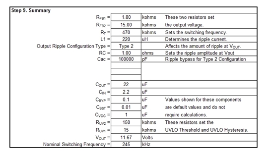

I have had some LM5017 regulators fail.
What I found is that they worked fine, then when powered off it would not restart.
I replaced the LM5017 and it powered up perfectly.
There is no physical damage to the LM5017
I did notice that the inductor was warm after it failed.
Please can you check if there is a configuration problem, or a bad batch and advise why these units have failed.
My settings are as follows:
  • Here is a bit more information.
    Vin ranges from 40 - 90 volts
    current and voltage output is around 30ma @10.15v
    when it failed the input was at a constant 60v on a lab psu
    I have ruled out the start-up regulator, because VCC is still outputting 7.6v
  • Hi Andrew,
    How do you turn off the regulator, using UVLO or VIN?
    Is the failure repeatable? Did you observe the inductor current/switch node when part was turned off/on?

  • Hi Vijay
    The main power feed is shut down, so VIN should shut down the regulator.
    It dose have a input capacitor, so it is possible that as the voltage collapses UVLO shuts off the regulator first.
    I can raise the level of UVLO to 25v so that it would cut out sooner as the voltage collapses.
    No it is not repeatable. I haven't looked at the inductor current when turned off, the load was minimal at around 30ma on the output.
    Is it possible that the moisture sensitivity of the S08 device could cause this type or failure?
    I do not know how they were handled at the factory.
    Andrew
  • Hi Andrew,
    If VIN is down the output capacitor will discharge through the body diode of the buck FET to VIN. If COUT was really big this may heat up the inductor, as you have observed, and possibly stress the FET. But the COUT is not that big in your application.
    It is difficult for me to comment on the reason of failure if it is not repeatable & without looking at any waveforms. You can submit the failed devices through your local TI sales channel for failure analysis.
    Vijay
