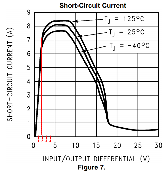

When Vin:5V,Vout:3.3V are set,how much is output current ?
On datasheet_P4,Minimum Load current is 5 to 10mA when Vin - Vout = 25V however how to calculate isn't written on datasheet.
I am looking forward to your reply.
Best regards.
  • That would be a Vin-Vout of 1.7V, just above the 1.5V minimum.
    I would estimate the full load current to be about 6A.+/- 1A. It would not take too much variation in either the slope, or the differential voltage, to make a dramatic change in the available output current.
