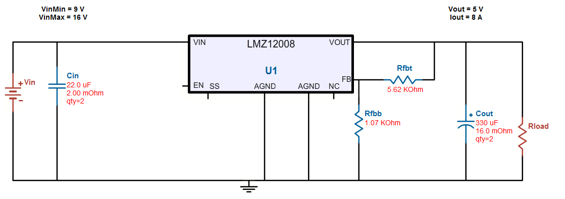

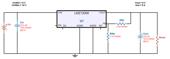

  • Hey Donald Jones ,
    Thanks a lot for your explanation about the LM1084's heating issue. As you recommended, I looked into LMZ12008.
    It looks like a far better solution for my scenario. I have few concerns about the LMZ12008.  (Vin - 16V, Vout - 5V, Current - 5A)
    • Is it necessary to use a fan and a heat sink?
    • is it necessary to use any BASIC type protection circuitry ?
    • In the schematic, why does it say "qty=2" in Cin and Cout ??
    Circuit attached.
  • " .... Is it necessary to use a fan and a heat sink ..."
    At 5V and 5A out, the LMZ12008 efficiency would be near 90%. For 25W at the load, that would be a bit less than 3W dissipated in the LMZ12008. The expectation is that the PCB would be the only heatsink required, and no fan would be needed. The pcb should be multi-layer with several thermal vias under the package to the internal ground copper plane, and 2oz copper on top and bottom sides. The LMZ12008 datasheet has a section for this, see : "POWER DISSIPATION AND BOARD THERMAL REQUIREMENTS"..
    " ... is it necessary to use any BASIC type protection circuitry ?"
    Not sure what qualifies for BASIC protection circutry in your application. But I would say 'probably'.
    " ... In the schematic, why does it say "qty=2" in Cin and Cout ??"
    The suggestion is to use two in parallel to lower the effects of ESR in the input and output capacitance. This is not mandatory, but it is certainly encouraged.
    An LMZ12008 eval board is available from TI now, and Digi-Key shows 1@ in stock this morning.
         TI part #: LMZ12008EVAL/NOPB  (approx $25USD)
         Digi-Key part #: LMZ12008EVAL/NOPB-ND
    http://www.ti.com/tool/lmz12008eval
    and the Users Guide for this eval board ...
    http://www.ti.com/lit/ug/snva478c/snva478c.pdf
