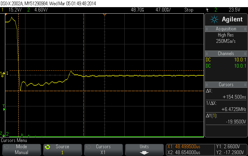

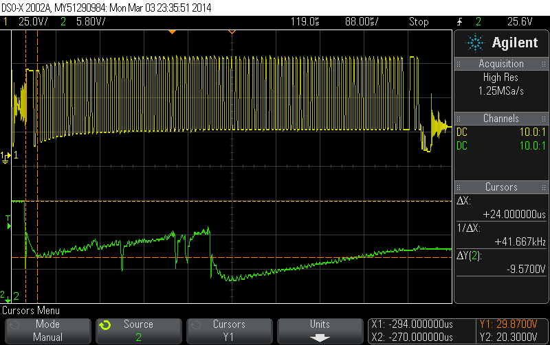

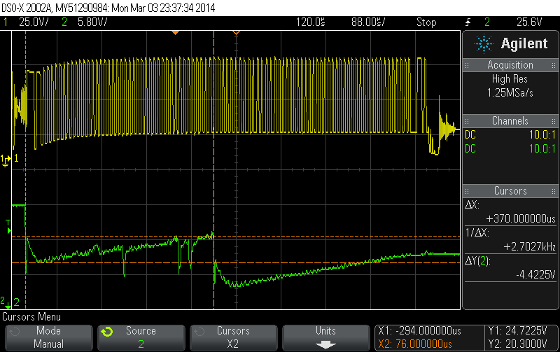

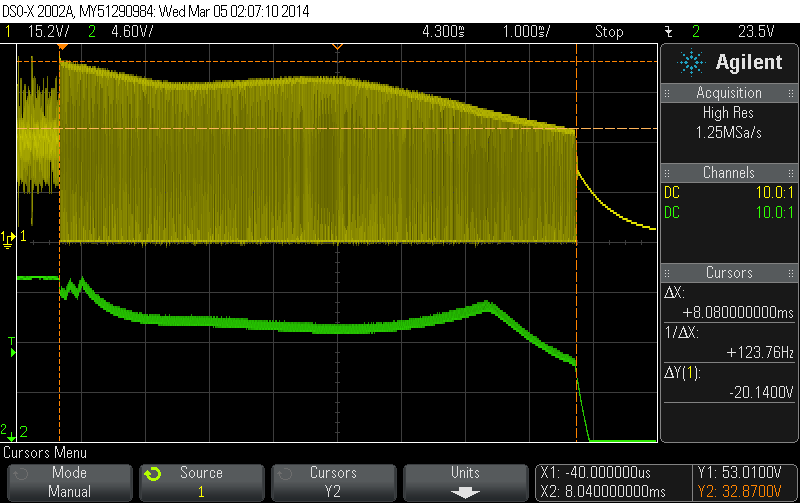

Here are some captures of failing converter. Yellow traces are BOOT to GND and green are the output.
The converter fails less than 800 microseconds after conecting fully discharged 1000 uF alluminum capacitor.
Y cursors show what happens with the output voltage after connecting the cap.

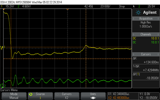

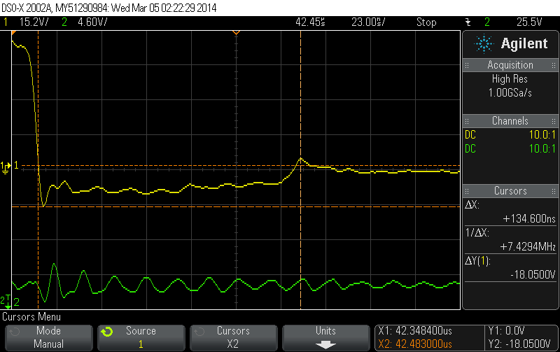

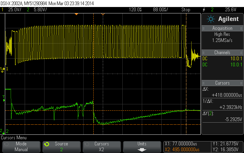

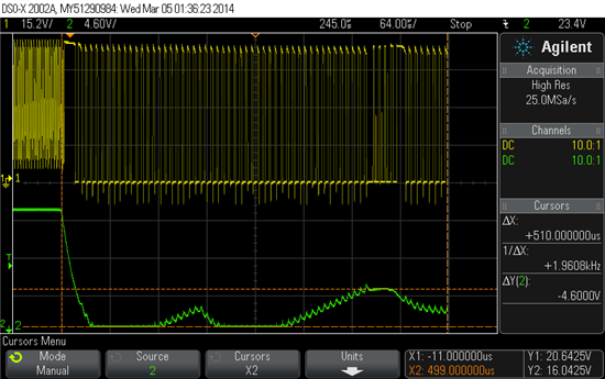

    I have 2 scenarios with SW node voltage under examination. The first one is connecting a 1000 uF capacitor:
    The negative spikes can be easily seen on the yellow trace. Here is a close up:

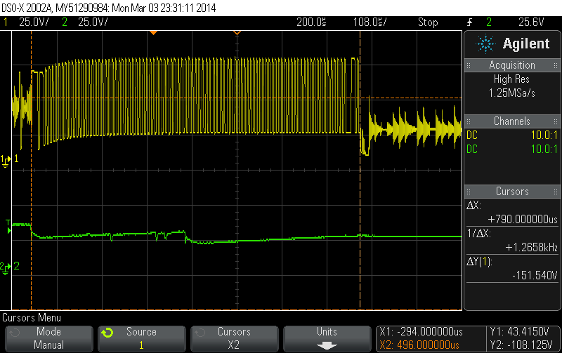

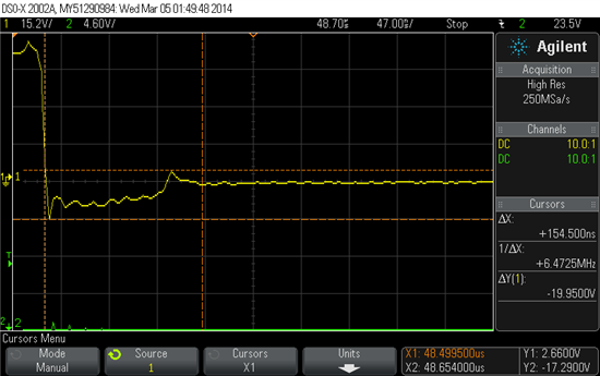

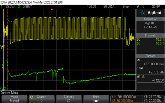

    The second scenario is connecting 1.2 ohm resistor. At 30V this should yeld 25 Amps.
    After 8 ms in the overload the microcontroller shuts down the converter. And the close up of the spikes at SW node:
    Following your advice I've added zener diode (BZX55C15) paralel to the bootstrap capacitor and this saved the soul of LM5088. In fact this solves my issue with controller not surviving output short circuit.
