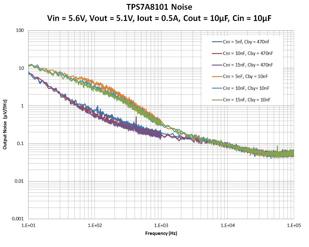

Hi
Could you tell me noise spec at TPS7A8101?
Conditions is below
Vin:5.6V
Vout:5.1V
Iout:0.5A
Cbypass=470nF
Cin=10uF
Cout=10uF
①Cnr=10nF
②Cnr=5nF
③Cnr=15nF
masa
Hi Masa,
Please allow us up to two weeks to take these measurements for you. As all three of your Cnr caps are relatively close in capacitance, please note that there will not be much variation in the noise of these conditions.

Hi Ryan
I am very sorry.
Would you measure additional following below conditions?
Vin:5.6V Vout:5.1V Cnr:10nF Cbypass:10nF
All condition is below.
Vin:5.6V
Vout:5.1V
Iout:0.5A
Cin=10uF
Cout=10uF
①Cnr=10nF Cbypass=470nF
②Cnr=5nF Cbypass=470nF
③Cnr=15nF Cbypass=470nF
④Cnr=10nF Cbypass=10nF
⑤Cnr=5nF Cbypass=10nF
⑥Cnr=15nF Cbypass=10nF
masa
Hi Ryan
Thank you for your mesurement data and quick responce!
masa
