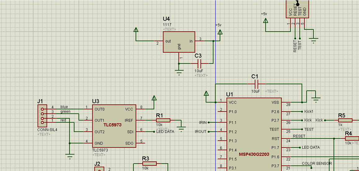

Communicate with TLC59731 by one wire interface error.
Other Parts Discussed in Thread: MSP430G2553, TLC59731, MSP430G2403
Dear Sir..!
Could you please help me to debug the error when i try to communicate with TLC59731 by single wire interface, the controller i use is MSP430G2553,i've check the signal by osilloscope then it looks fairly correct but output on OUT1,OUT2,OUT0 of its didn't changed .My source code and circuit diagram as following:
