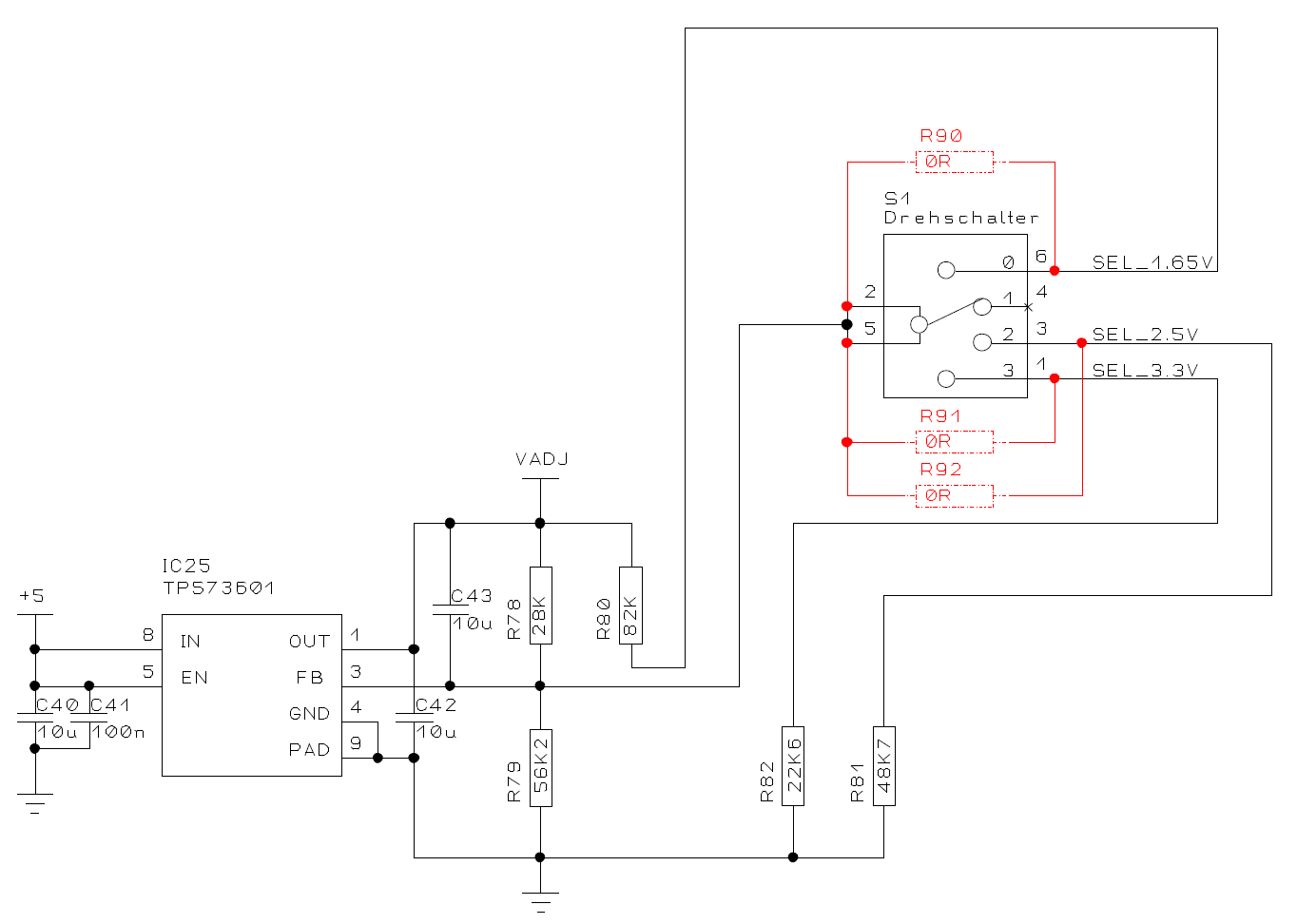

TPS73601DRB Non-deterministic power-up behviour

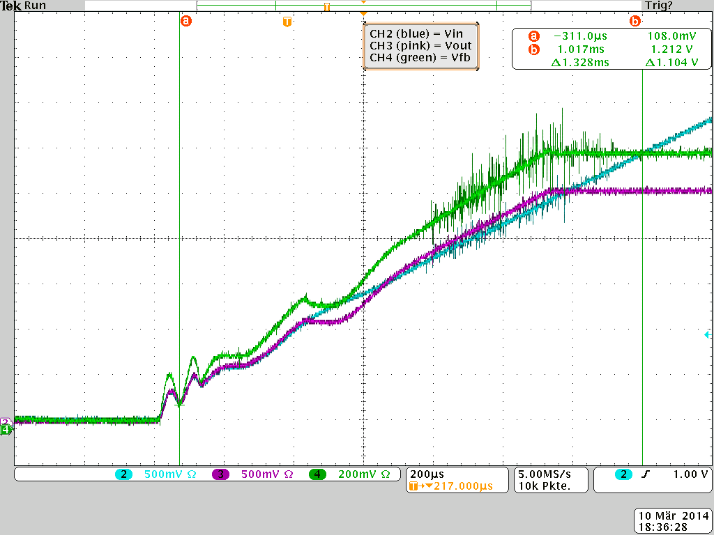

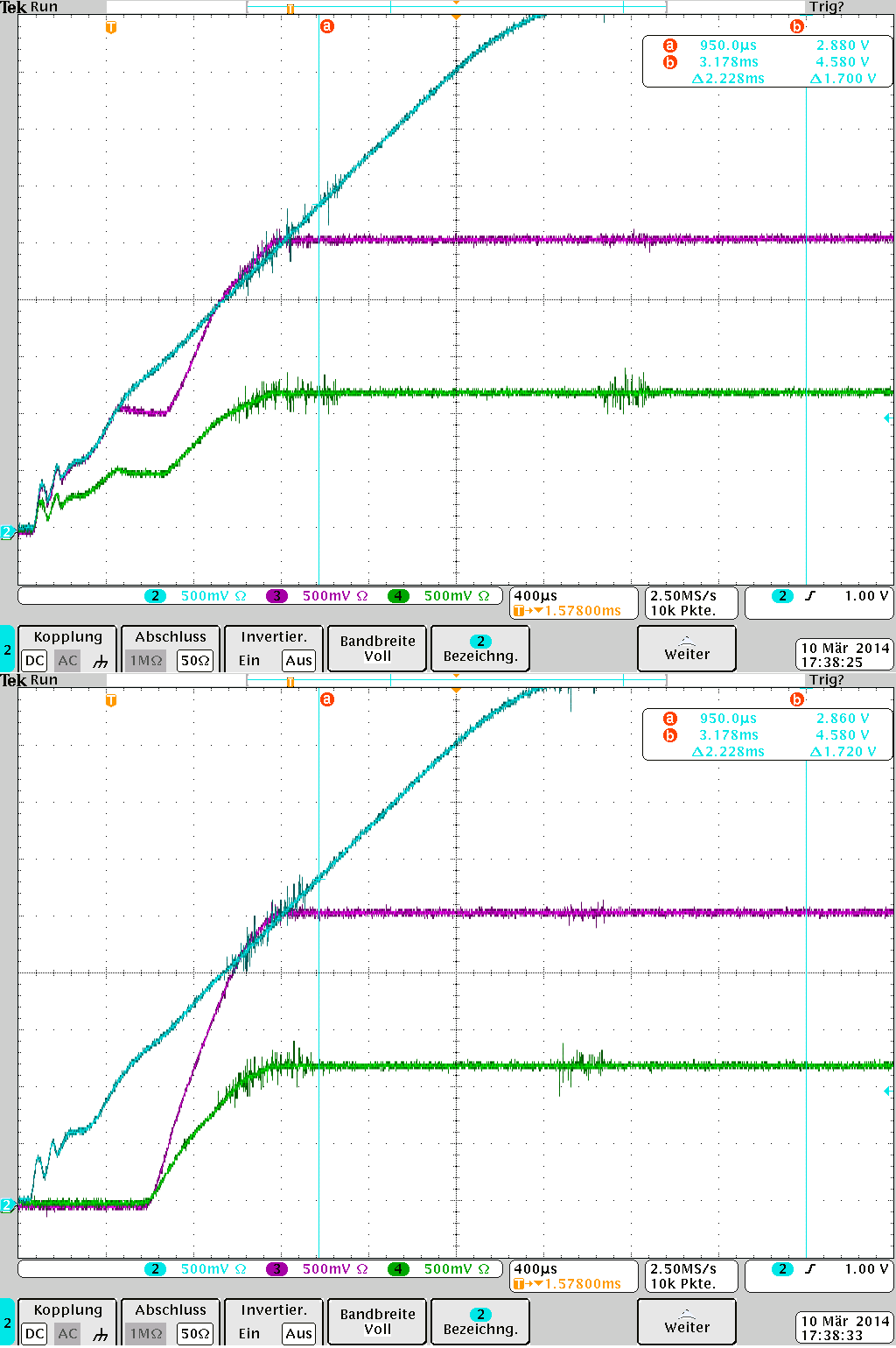

We are using the TPS73601DRB on one of our new CMC modules and we are experiencing a power-up behaviour that is not deterministic. See attached scope shots.
Sometimes the Output Voltage (pink) follows the Input Voltage (blue) and sometimes the Output Voltage has a defined power-up ramp as soon as the Input Voltage gets to a caertain level.
What is the reason for this?
