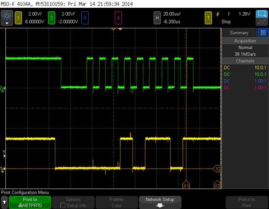

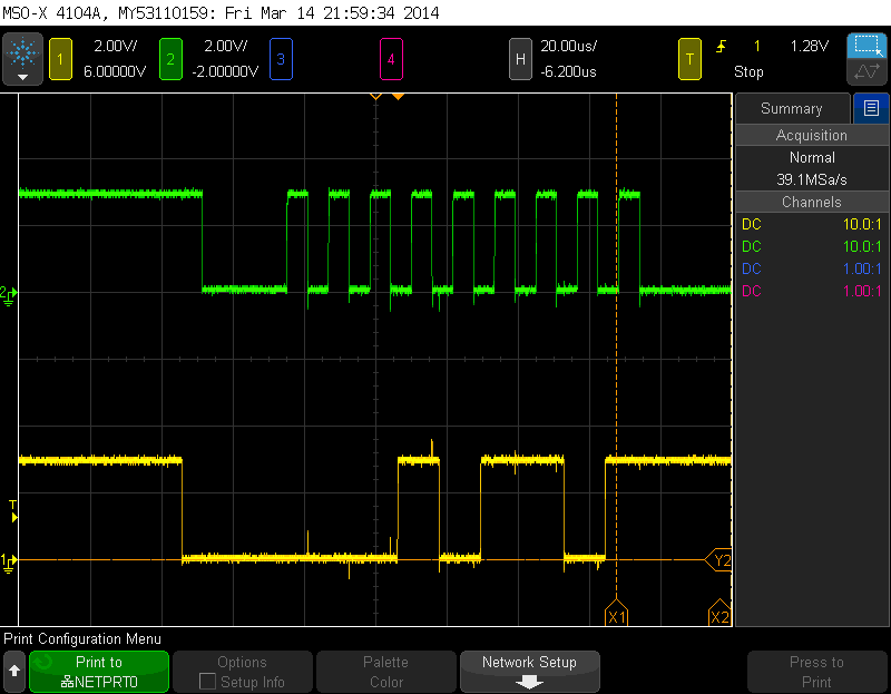

    By using I2C probe command the BQ28550 is not detected, below is the translation of the capture done with the oscilloscope..
    Startbit 0 0 0 1 0 1 1 R/W(0) NACK --> NACK means that peripheral is not correctly addressed?

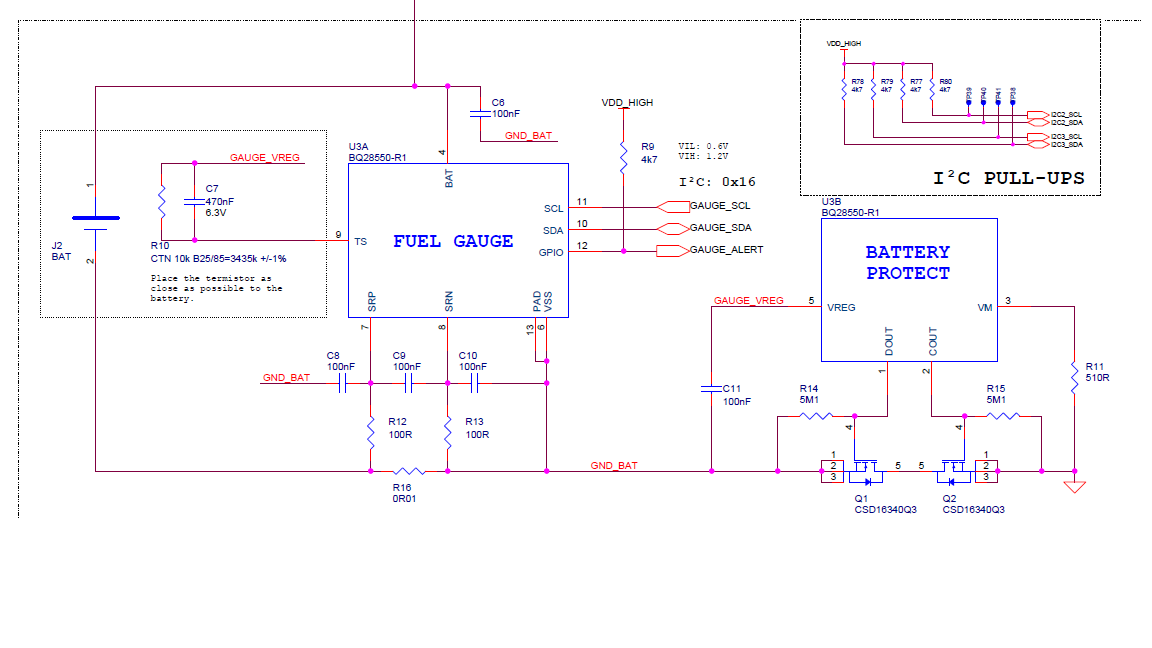

    In parallel of the debug phase to talk with the BQ28550-R1, I would like to have your feedback on the hardware implementation to be sure that evrything is correct. I2C2_SDA and I2C2_SCL with 4.7 KOhms PULL-UP are the I2C lines connected to the BQ28550-R1 (VDD_HIGH is 3.15volt and the i2C clock measured is around 85Khertz). Plesae let me know if something is wrong and that could be the reason of the communication issue.
  • I would suggest you isolate the gauge and hook a scope probe to the comm lines to see what the wave form looks like. your schematic shows the logic levels are 0.6V and 1.2 V for low and high respectively. You are pushing the limits with those values based on what's stated in the data sheet for the device. Also I would suggest reducing the pull-up resistors to a lesser value like 3.3 K.

    VIL and VIH on schematic are the value from datasheet, this is a reminder from the spec (no interest on schematic), they do not reflect values measured with scope. I will capture waveforms and attach to the discussion.
    PULL-UP value has been reduced to  3.3K and communication issue is the same. Your proposal to isolate the gauge on the bus could be a solution but we need to cut some lines, the other device on the same bus is the PMIC for the application processor.

  • Hello Onyx,
    Below the waveform captured on smbus interface.
    Bye,
    Jean-Marie
