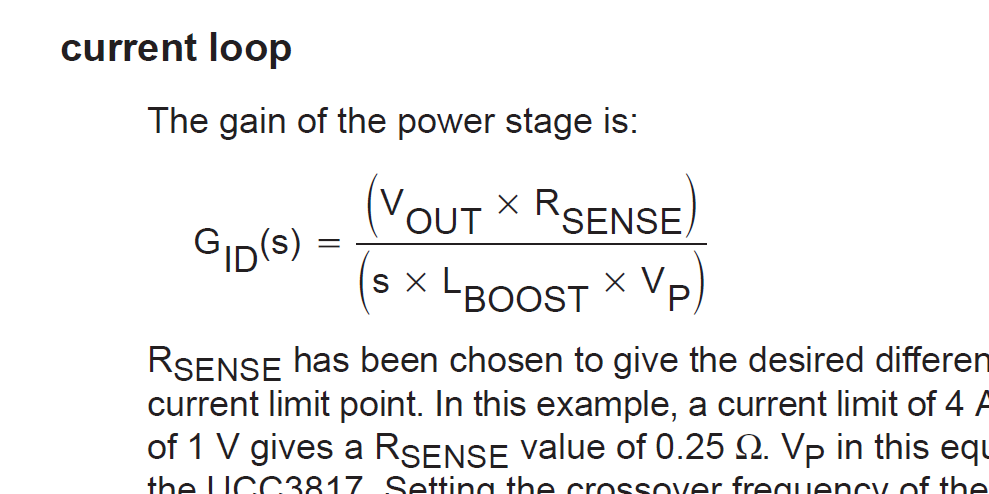

For calculating the Power stage gain (page 12 - ucc 2818 datasheet) ,which inductance value we should use. Is it the no load inductance value or the rolled off value at full load low line condition?
Please let me know
