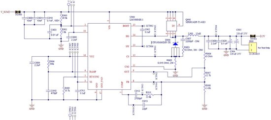

I am trying to reduce the ringing at the output of the regulator by shaping the gate drive.  However, when I add a 40 ohm resistor between the HG pin to the gate of the mosfet, everything becomes unstable.  The ramp signal looks very small, the frequency and duty cylce are all wrong.  The input capacitance of the FET is about 1975pF.  The circuit did work with a 20 ohm gate resistor.  What is the limiting factor?

    Can you post a schematic and provide the switching frequency and FET part numbers?
    It would also be interesting to see you output waveforms with the gate resistors you have tested with.
    On a side note. Have you considered including an RC snubber to manage the switch ringing?
    Ryan,
    Schematics is shown above.  The switching frequency is 525kHz.  I did try the snubber as in the schematics but I didn't see any significant improvment from it.
    The FET is Vishay p/n SIR882ADP http://www.vishay.com/docs/63367/sir882adp.pdf.  What is the preprogrammed deadtime?  Is it in the LM5088's datasheet?

  • Hello Ron,
    You want to connect the snubber straight to ground not through the the CS resistor.
    Since this device is Asynchronous (must have slipped my mind) there is no dead-time characteristic because the diode switches when the proper potential exists. However even in this case if the diode has too large of a junction capacitance it will take too long to shut off.

  • Hi
    I reviewed your schematic and found SW pin is not connected to the source connection of your high-side MOSFET. This might be the root cause.
    If any other electrical connection to ICT908/909, switching frequency can be changed.
  • Hi Eric, Yes, the schematics is missing a connection. I have been testing with a jumper added from the SW pin to the high side of the inductor. Ron
