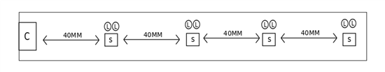

I'm trying to find the best driver for my application but I haven't be able to decide.  I think I can get some help choosing here.
I need to control the brightness of 4 groups of dual LEDs independently. The driver have to be as small as possible. The LEDs can use up to 70mA. The change in brightness should be fast, 600uS max between complete brightness set and turn off.  I only need 8 leves of brightness so if there is a part that doesn't use PWM to control the power would be even better.
The setup is as the following diagram:
S are light sensors, L Leds and C a connector where all control signals and power come from.
So I was trying to look for a driver like a ws2811 for each group so the current loop could be reduced. The closest thing I could find was the TLC59731 but it only can deliver up to 50mA of current.  I couldn't find any other driver that had an small package and low component count.
Then I thought of using a TLC5916 (8 channel) and then it would control a TL4242 for each LED. But then this wouldn't be fast enough and less cheap.
So now I think I will use the TLC5916 close to the connector and from there control the 8 LEDs. I will separate the power supplies of LEDs and Sensors  but I still fear I will have high emissions.
So what would you choose in my case? Do you know any better solution?
Also I would like to know how does the TLC5916 implements the Current Gain Control since is not clear in the datasheet. It seems to be just a linear implementation and I would like to know if this is correct. I mean, the method of controlling the current in the LED is not PWM. This is important for me because if I set the current to 30mA for example I won't have to wait several cycles of a PWM to get the correct reading from the light sensor.
Any help will be greatly appreciated!

    Thank you, the reason we would need something like that is because first, it would only need 1 current adjustment pin which would be share by all LEDs and 1 pin to turn on/off each LED. A controller like that could probably be made in a sot-5 or smaller (if power isn't a problem) and be below (other side of the PCB) each LED so I would fit in a small board and current loop of the fast switching LED could be kept to a minimum.
    The problem I'm facing right now, is that since my LEDs are at last 40mm apart the current for each LED have to travel from the driver to the LED and back and that not only will emit a lot but also it can affect my sensors, especially if they share power.
    I'm tempting of just using a very fast PWM signal and a transistor under each LED with a resistor. The problem is that like that I don't have current control so the tolerances in resistors and LEDS will make difference in the light they all emit for a certain power level. Also, I would have to wait at least a couple of cycles of the pwm to be able to read the RMS value read by each sensor. Since I have to read the value of  all the combinations of LEDs light and ambient light  of each sensor I end up doing 120 readings in 1000 mS that means that I have less than 1 mS for each conversion and commutation of each LED. In fact is only 500uS since the output of the sensor takes 500uS to settle.
    Anyway, I might need to go for the TLC5922 but I would prefer the same device with one channel and just multiplex the signal using transistors. Also I will have to give a different power supply with different ground for LEDs and Sensors.

    I have to read 10 sensors 120 times in 100ms. For the different configurations I have, that is, LED off  sensor 1, LED 1 sensor 1
    LED 2 sensor1, etc for each of the 8 LEDs of each sensor. So what I mean is, I will need to be turning on and off each LED for each reading (Or what is the same, adjusting the power, which in the worst case is going from 0 DC to max power DC=127). So I have to be turning them on/off a bit fast and that makes a repetitive spike in current.
    The problem is not only noise, even when I have time to let it settle, the current spikes produces spikes in the signal voltage. When then sensor is saturated (That is, 3.3V in my case) and I switch the LEDs (one bye one) I get spikes in the voltage of almost 4V in the sensor signal lines and power. That can reset mi MCU or damage it or the sensor.
    Of course I can add TVS and other protections to avoid that situation but I want to avoid those spikes as much as possible.  The best solution for me is to reduce the current path for the LEDs so the inductance is reduced to a minimum.
    Of course, all those test were made using old PCB's and for the real PCB for the project I want to avoid those problems. In fact I will separate the sensors supply and the LED's supplies.
