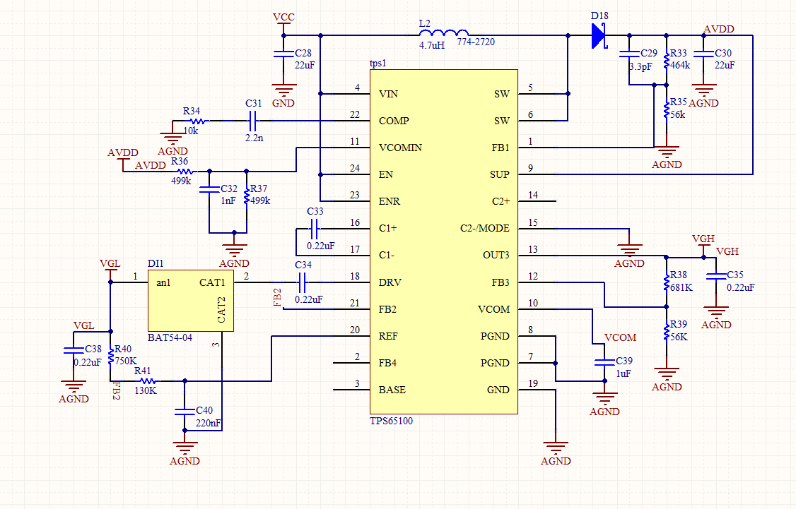

i've designed a board to control a LCD display and I'm trying supply it with TPS65100 IC but i can't get it working (I attach schematic). When I turn on the board, AVDD  rise to near 10 V but then it fall down and it seems that the IC stops regulating. I read documentacion several times and I can't know where is the problem.
Can TPS65100 works without load? Should really thermal pad be connected to PGND? I forgot to connect it in the design but then I connected it with a wire and it still not working.
Input voltage is 5 V. AVDD should be 10.64 V, VGL -7 and VGH 16.
Thank you very much.
  • Hello Adrian,
    Please check the connection of FB2. I seems that you connected FB2 to REF and therefore FB2 is too high (should be at GND level when the output is in regulation), indicating a short on VGL and then the IC will shut down because of the protection feature.
    You need to connect FB2 between R25 and R27.
    Brigitte
    sorry, I've already realized of that fail before I post last message. I routed FB2 between R25 and R26 and it still shutdown. Thank you very much for your reply

  • Hello Adrian,
    Did you check the fbn connection?
    Brigitte
  • I have checked all FB connections with a polymeter. FB2 between R25 and R27, FBq between R19 and T20, FB3 between R24 and R26. Voltage in this pins are FB1 350 mV, FB2 1.09 V and FB3 0V.

  • In the comment thread, the FB2 miswire is noted in the wrong location; however, I see Pin 20 REF connected to ground and in the Fig 24 typical application, REF should be on the other side of the cap between Rx and Cy.

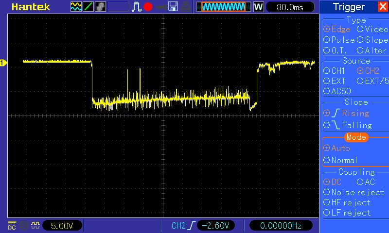

  • Hello again,
    last year i've got similar problem and after all issue was resolved, but I didn't know how. I change several times IC and check in differents PCB and it start working. I've mounted then more than 10 PCBs with this design and It's work without problem.
    Now, i've redesing the PCB (i keep schematic wihtout modification) and again I've got same problem.  IC starts regulating and after 200 ms it stops. I can see all signals has been stopped but I don't know with one has the problem.
    Could anybody help to find the problem? Thank you very much.
  • Hello Alvarez,
    Can you attach a scope of all the COMP- Pin, VGL and SW- Pin? In the schematic i cant find anything suspicious, so i need to know more about the application. Do you append a load on any of the outputs?
    Ilona

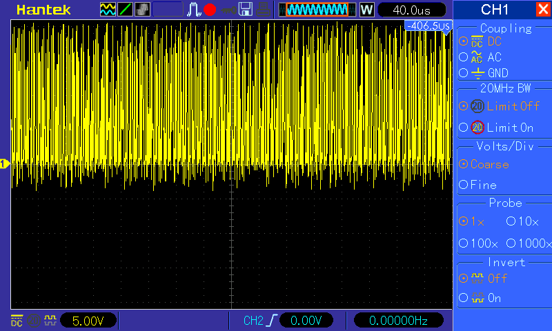

  • Hello Ilona,
    thank you very much for your reply. There isn't load on any of the outputs.
    I attach a screenshot of all the signals.
    This is SW-Pin
    This is sw-pin detail.
    This is VGL
    And lastly COMP
    Thank you very much
  • Hello Alvarez,
    It looks like it is not switching properly and it seems that the inductance is saturating. Can you tell me what Inductance you are using? Did you check if your power´- components are working fine (rectifier- diode, inductance)?
    Thank you,
    ilona
    It is mounted an inductance of 3,3 uH (7447745033 from Wurth Elektronik). Is the same I'd mounted in the other PCB and it works. I've already change inductors from one PCB to another and the behavior is the same.
