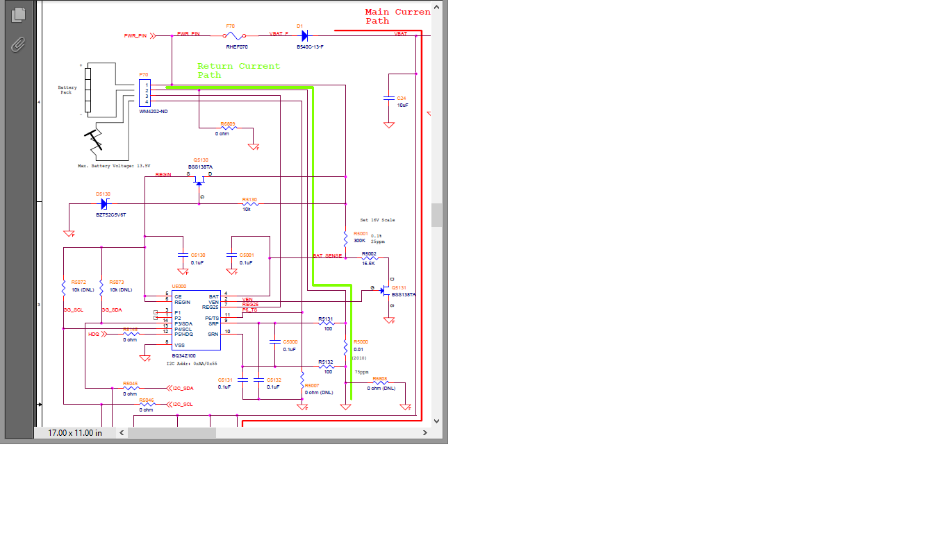

    If you can send a schematic for the bq34z100 section of you module, then I can review it for problems that may affect performance.

    If you could send a schematic of your module, then I will review it for potential problems. You can send one of the modules to me and I can try to find the problem, if you want to do that.
  • The HDQ line is not intended for use at this stage and is connected to a High-Z input. The I2C lines have a 10K resistor listed as DNL (not populated) but are actually pulled up via a 1.5K elsewhere. Resistor R5808 in the lower right corner is also listed as DNL and is not populated
  • You will probably find that 1.5 kohm pull-up resistors are too small and the I2C signals are not pulling low enough for reliable operation. We recommend using 10 kohm resistors. Please try using pull-up resistors that are larger than 5 kohm.
  • I agree that 1.5K pullups is on the small side, and the hardware engineers are changing that. But that doesn't exactly explain why an erase command would exit ROM mode instead of being ignored. I don't think this is an I2C problem.
  • I misspoke - the hardware guys were questioning the serial resistors on the I2C lines - your EVM has 200ohm, while our board does not. Can I assume that the serial resistance is unnecessary?

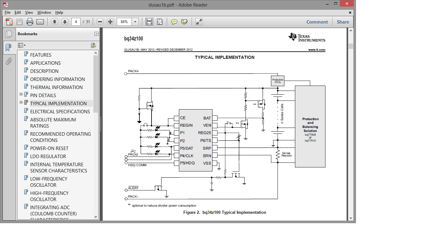

  • Apparently we are supposed to have a 1uF capacitor between REG25 and Vss.
    This is missing from your reference diagram for the BQ34Z100.
    Can you confirm that the missing cap can cause spontaneous resets of your chip? For the past month we have been trying to figure out what appears to be a chip reset during internal flash write/erase.

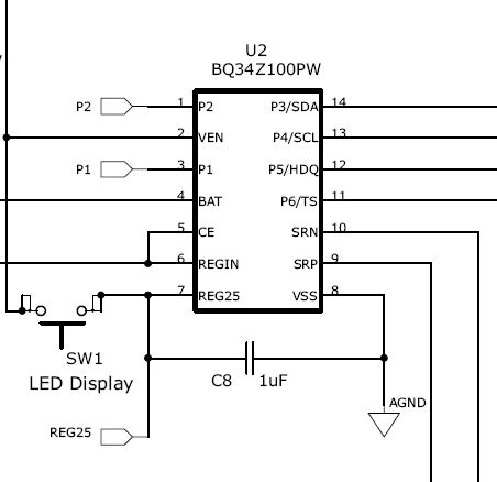

  • We have a 1uF capacitor between REG25 and VSS in the reference design. This clip is from the schematic in the datasheet and EVM User's Guide.
  • Correction - it is missing from the "typical implementation" diagram in Figure 2. It is present in the application schematics. There is also text in the electrical specs indicating 1uF across LDO25, which is presumably REG25.
    Can you confirm that the missing capacitor can cause spontaneous resets?
  • I can confirm that the BQ34Z100 resets on flash write without the 1uF capacitor between REG25 and VSS. This capacitor is missing from the Typical Implementation diagram in Figure 2 of slusau1b.pdf.
    Perhaps TI could fix the documentation? The external capacitor is required for operation, but is not listed in the Typical Implementation. The need for the capacitor is not obvious - even the experts at TI missed it when reviewing my schematic last month.

  • The 1uF capacitor is required. The Typical Implementation diagram in Figure 2 is not a detailed schematic. There are other external components missing from it as well. You should refer to the Application Schematics as a detailed reference.
