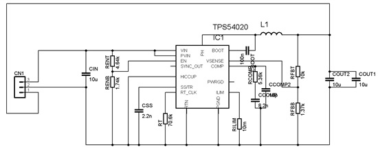

I made a small 15V to 5V  (7A out) step down converter according to webench:
7713.webench_design_3562831_6_903630554.pdf
Upon turning the power on (15V, output floating), the device immediately gets hot.

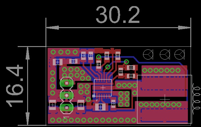

    The two RT resistors are placed in parallel, as I could not find a value that was required after the report was generated. This is the PCB layout:
    It is a standard 1oz 1.6mm FR4. with 0.6mm vias. Dimensions in mm.
    Sorry, the layout has all the names deleted because it is too small.
  • Wojciech,
    I don't see any big issues with the schematic, but there are issues with the layout. As you mention there are no RefDes's on the layout picture, but I think your 10uF input cap is located at the very north west corner of your PWB as pictured. Is that correct? If so, that will definitely cause issues. The input cap should be butted right up against the device, placed as close to the device as your manufacturing rules allow. The cap should be right up against the outer two strips of the HotRod package. It must also be on the same side of the board as the device and not connected through vias. Vias will add far too much inductance and resistance. The di/dt between the input cap and the device is extreme, so this connection must be done well.
    Can you take a scope shot of the waveform at PH to PGND and PVIN to PGND during operation? That might provide some important information.
    There are also other issues with the layout. If you are interested you can provide your email address and I can contact you off line.
    MC.
  • You are right about the location of the CIN,
    Does that mean I might have too large ripple into the device (and EM noise) and possibly oscillations?
    I will adhere to the suggestion and post here the result as soon as possible (I am not in the lab currently).
    Unfortunately I can't get access to the oscilloscope until after Monday, only then could I post pictures.
    I am very interested to learn more about layout, here is my email: wojtek(.)marcinek(@)gmail(.)com
    Thank you,
    Wojciech

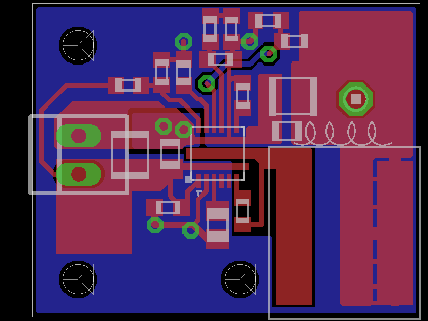

  • Hello everybody.
    I have redesigned the voltage regulator from start. I moved the capacitors close to the chip and got rid of all the vias in the hight current loops (which were made smaller).
    The new layout looks like this:
    This layout works very well, I am getting desired output voltage and the power consumption is about 10mA at 15V when open circuit.
    I should also mention I did the PCB at home with toner transfer, I have no solder resist and the board sill works!
    I soldered it with solder paste and bathed in isopropyl alcohol to dissolve all the remaining flux/rosin/stuff.
    For all those who have similar problem, if the layout is closer to what I had in the beginning, I suggest to change it. If the layout is closer to my final, unfortunately I do not know what might actually be the problem.
    Wojciech
