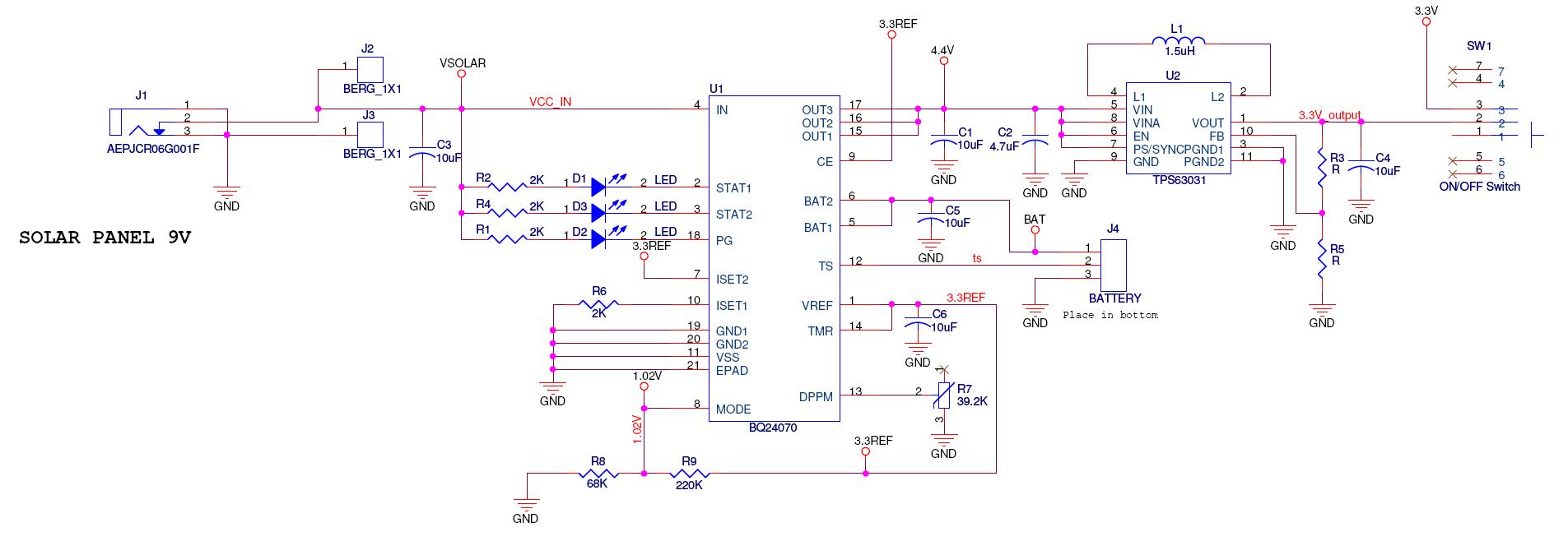

I am designing the power supply module for my application, a standalone one. So it just use solar power (solar panel + Li-Ion/Li-Po battery).
My system needs both 4.4V and 3.3V. So, I decided to use BQ24070 and TPS62273 (400mA for 3.3V source is okay).
Some requirements:
-  The normal total current of system when it actives is about 0.5A and (0.5+2) = 2.5A peak. (Generally, the power demand of system when it actives is larger than solar panel's capacity)
-  4.4V source (VOUT from BQ24070) must between 3.4V..4.5V at all times (including peak current)
The problem is I have no experiment in designing with these devices. So would you mind checking my design for me if it is okay with my application or not?
Somethings I wonder in this design:
- Input voltage in MODE pin of BQ24070 (for selecting high level). I have to use 3.3V reference from itself to make a 1.02V reference. Is this okay?
- Input voltage in ISET2 pin of BQ24070 (for selecting high level). I used VOUT for this.
- Inductor's value for TPS62273 is 47uH, is this suitable?
I have attached it in this post:
6545.SCHEMATIC1 _ PAGE1.pdf
Thanks in advance!
  • MODE and ISET2 are digital inputs that are usually controlled by a micro-controller.  They should be set either high or low (high for your application).  A high could be the 3.3V provided by the IC or Vin if it does not go above 7V.  Along with CE, they should not be powered from the output of the IC as the output voltage may not be there--in the case of no battery or dead battery.
    The TPS62273 is optimized for use with a 2.2uH inductor.  It requires an inductor between 1.5 and 4.7 uH.  47uH is far too big.
    Also, your DPPM level is set too high--4.5V.  The IC will output 4.4V.  Since this voltage is below DPPM, the IC will never charge the battery and will always be in DPPM mode.  You may want to use the bq24071, which regulates to 6V.
  • My application also has a microcontroller, but it gets power from TPS62273. That means only when BQ24070 operates and provides 4.4V, the microcontroller can control MODE and ISET2 pin. Is this okay?
    According to BQ24070's datasheet, VIL for MODE input is 0.975V-1.025V (typ. 1V) and VIH for MODE input is VIL + 0.01 to VIL += 0.024. That means voltage on MODE pin should not exceed 1.025+0.024=1.049V. So can I use 3.3V-7V for this pin to set it to high level?
    My application don't use any extra power except solar power. So I can not find another power source to set CE high. Or you mean that I should use Vsolar for this pin?
    I will change the inductor for TPS62273 to 2.2uH. Thanks.
    Sorry about RDPPM, I almost forgot it when I used reference design for BQ24071 to design my application. I think VDPPM I may need is 3.7-3.8V. So RDPPM here should be 33K.
    I must use BQ24070 when my devices can not operate with 6V, just 3.4-4.5V and 3.3V only:)
  • It doesn't matter what the MODE and CE pins are at if there is no solarpower, as the battery will not charge without an input source.  So, yes, driving them with your uC is ok.
    MODE is a digital input.  The spec for the MODE pin is the spec for the trip points that determine if the pin is read as a high or low.  Per the block diagram on page 8, MODE is compared against a 1V reference.  This is a very precise reference with the tolerances listed in the spec table.  The rating of the MODE pin is shown on page3.
    For generating the 3.3V, you should look at the TPS63031.  This buck and boost converter will allow the battery to go down below 3.3V and yet still regulate the 3.3V that your uC needs.

  • I would recommend buying the EVM for the bq24070 and the tps63030 and modifying those to your requirements.  This would be much simpler, cheaper, and faster than making your own board and would also validate the circuit.
    A few things that I noticed on the schematic:
    As described earlier in this thread, MODE is a digital input.  Just tie it to 3.3V.  Remove the voltage divider.
    Reduce C6 to less than 1 uF, per the datasheet requirements for the capacitor on Vref.

    I had to pause this project for a long time because other projects. Now I return to it.
    I have designed a new circuit using BQ24070 and TPS63031. What a pity that I can not use TPS54331 for 4.8V power source. I have to choose another device with lower efficiency for this.
    I corrected the circuit as your suggestions. Besides, I connected status output pins to my uC for reading status of BQ24070. I used 3.3V_REF from BQ24070 for this.
    This pin can supply 20mA (as datasheet said) and hope this will be enough for 3 status pins (~1,5mA for each).
    Would you mind checking the circuit again for me?
    Thanks.
    I attached the schematic pdf file:
  • On the TPS63031, I would recommend increasing the capacitor values, both input and output.  Equation 6 in the datasheet requires an 11uF capacitor for stability.  At 3.3V DC bias, your 5V 10uF will be more like 5uF or even less.  I recommend using 2 x 10uF @ 6.3V for the output and 10uF @ 6.3V for the input.  This is what was used when the datasheet data was taken (page 11 of the D/S).  Lastly, you may want to consider tying the PS/SYNC pin to ground to enable power save mode.  This is typically done in battery powered systems, but depends on your system requirements.
    For the bq24070, you should use 425 for the scale factor instead of 450.
    What is wrong with the TPS54331 in your application?  Do you need higher current?

  • Thank you very much for your corrections.
    I modified capacitor's value and connected PS/SYNC pin to GND.
    About the BQ24070, should I use an 390R resistor on ISET1 pin so that the maximum input current can rise to 2,72A? With this, every time the GSM modem boost the current up to 2A, the external power source can supply all the current my system needs and do not get power from the battery, avoid charging the battery frequently. Though the maximum rating input current of BQ24070 is 3,5A IN and 4A OUT, but the recommend input current is only 2A. I wonder this modification is good or bad for the system.
    I cannot use TPS54331 at present because the price of the external components for it is still high. (1x10uF@25V and 2x47uF@10V ceramic cap, inductor that can operate at 1MHz freq.). LM2596 is my temporary replacement. I hope I can use TPS54331 or TPS54620 in the very near future.
    I attached the corrected schematic. Would you mind checking it again to sure that I modified correctly as your suggestions.
    3288.SCHEMATIC1 _ PAGE1_fixed.pdf
    Thanks.
  • Yes, the schematic looks correct.
    The charging current should be set below 2A, per the recommended operating conditions spec for maximum input current.

  • I had a prototype board from the schematic I've attached here before. And it's operated differently with its functions.
    It seems the output of TPS63031 depends on PIC's clock frequency.
    I do not know the reason why it becomes like that.
    I've tested some cases: (at first, dsPICJ128MC706 was soldered. After that, I tried another PIC-dsPICJ128GP706 but the problem still occures)
    Power Sources: VIN -> LM2596 -> BQ24070 -> TPS63031

    Would you mind checking it for me? If you need layout or something else, please tell me.
  • This is a multi-stage circuit that needs to be debugged piece by piece.  To do this, look at each output voltage (4.8V, 4.4V, 3.3V) with a scope and see if they are stable.  Another thing to try is to not use the PIC, but simply use resistors as a load for now.  If this power supply can handle resistors and be stable, then the problem is in your PIC.

  • I've tried 2 PIC and the result didn't change, so I think the problem is not caused by PIC. I don't have a scope until next 5 days so I can't check it carefully. But I want to know is there any possibility that can cause devices operate like that? Why the TPS63031 output normally only when PIC operates at low clock freq? And what cause it raise the output voltage to 3.8V? I just want to know reasons so that I can find out what I have done wrong.
    So, if you know some reasons, please tell me. I'll check the board by a scope and tell you later.
    Thanks.
    P/S: All these devices were soldered by hand.
  • We need to debug this piece by piece.  Does the circuit work with a resistive load?  Is each voltage in the chain stable?  These are the kind of things to look at.
    The current that the PIC pulls could be changing with operating frequency.  The TPS63031 in your configuration may be unstable at some of these different loads.  Or some of the pins may not be soldered down properly.
    The TPS63031 has a power pad.  Hot air is the best way to attach these parts.  There can be damage when used with soldering irons.  Make sure all the pins, including the powerpad, are soldered down well.
