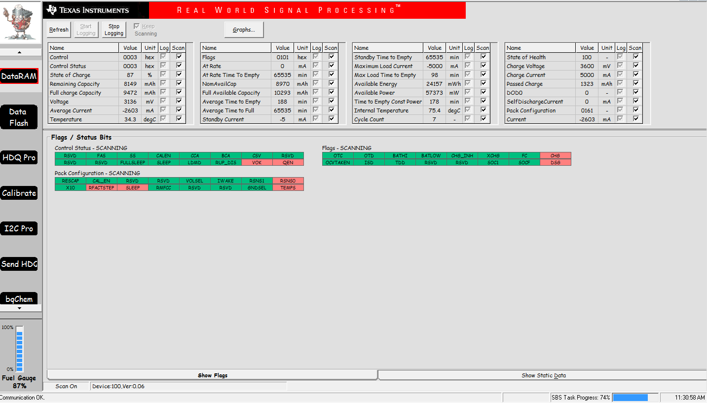

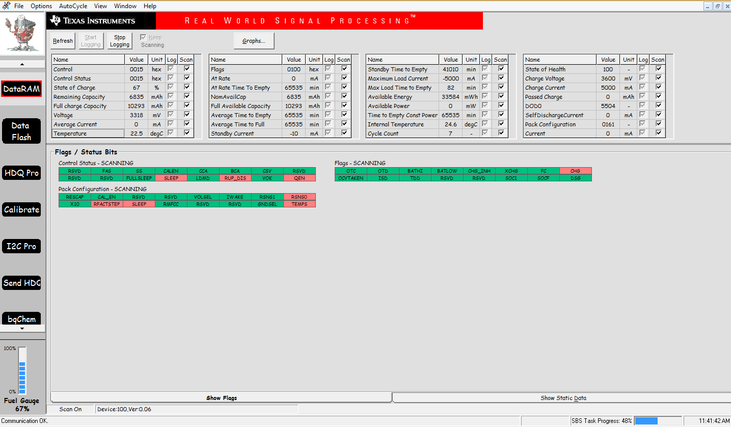

I am having a issue as soon as I try to discharge the battery through the EVM module.Tthe Bz34z100 chip instantly starts getting really hot and eventually stops communicating with the BQ software over the course of 1-2 mins after I plug in a discharge load. This will happen with a 40ma load or a 2 amp load, the same thing happens either way. I have not damaged the chip in any way and it seems I have everything setup right based on everything I have read.
When it gets hot it will pull about 500 mA @ 3.6v continuously. What could cause this? I'm assuming maybe it has to be  when something notices a discharge current flow and that causes the chip to do something that causes it to heat up?
After the chip heats up I have to leave it unplugged for 30 mins and then it will begin working again just fine until I try to start discharging from the battery.

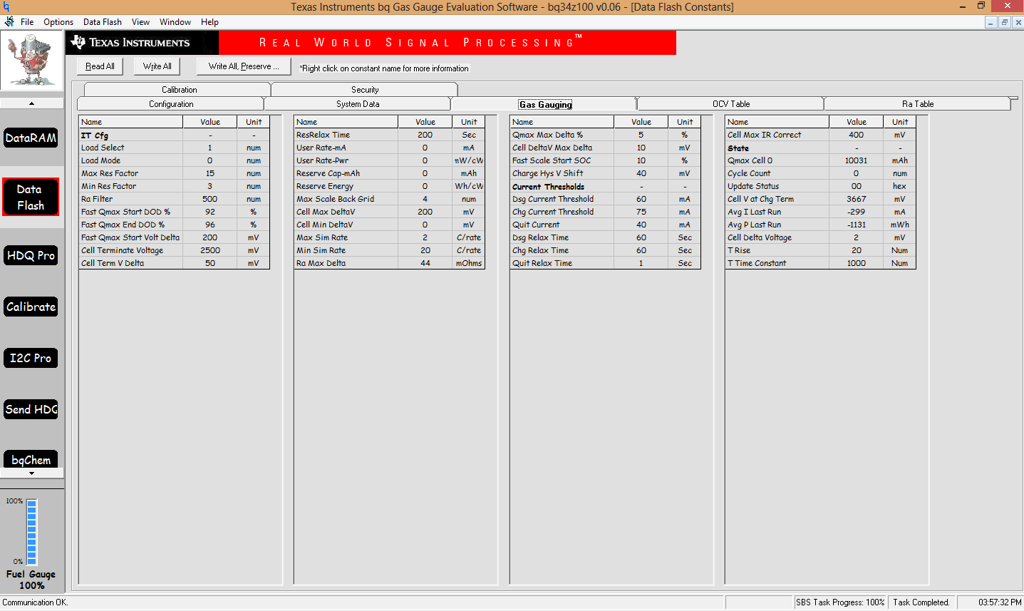

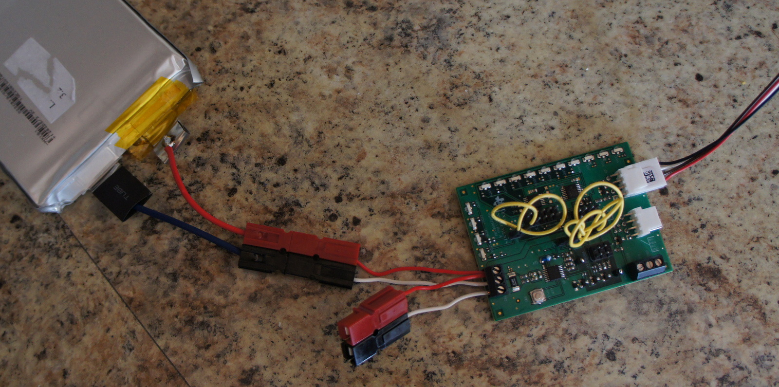

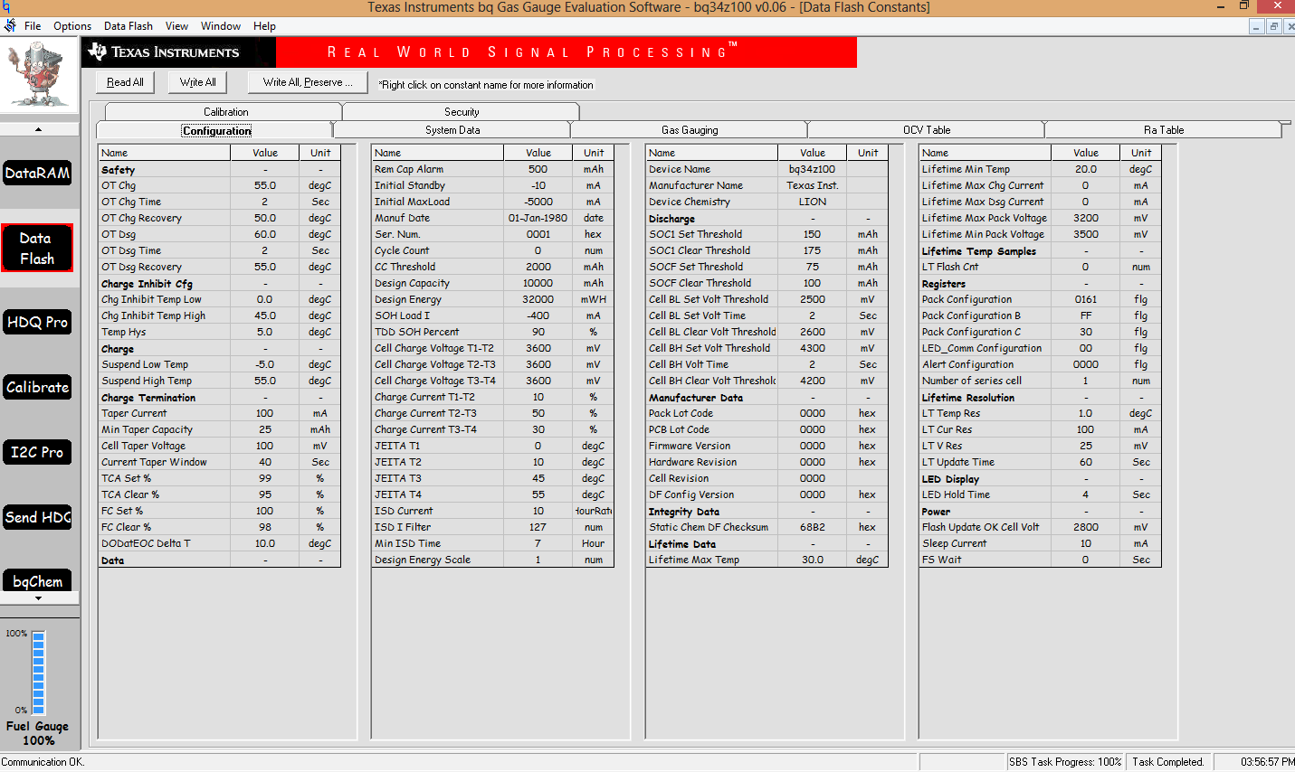

I'm attaching screenshots of the software settings and the board for review, hopefully somebody can catch something if its wrong. everything looks great otherwise.
  • Any ideas on why the chip heats up and shuts off when I try to pull power from the battery through the sense resistor?
  • Ryan,
    I do not see anything wrong in your picture and I do not see any issues on the bench with my EVM setup like yours. You must have a defective device. You can export a senc file and I will try it, but I do not see how the setup could cause the device to get hot.

    Your other post seems to have disappeared and I reviewed the parameters. You have the Term Voltage set to 3600mV and this is why you cannot get a capacity estimate. It needs to be set to the end of discharge voltage and this begs another question. You are designing a single cell pack with a LiFePo4 cell, so this is going to limit how low the cell voltage can go. You also need to send the IT Enable (21) command to turn Impedance Track on.

  • Yea I deleted that post because I got it working by changing the Terminate voltage back to 2.5 volts.
    At least now I know what was causing the problem now. Thank you.

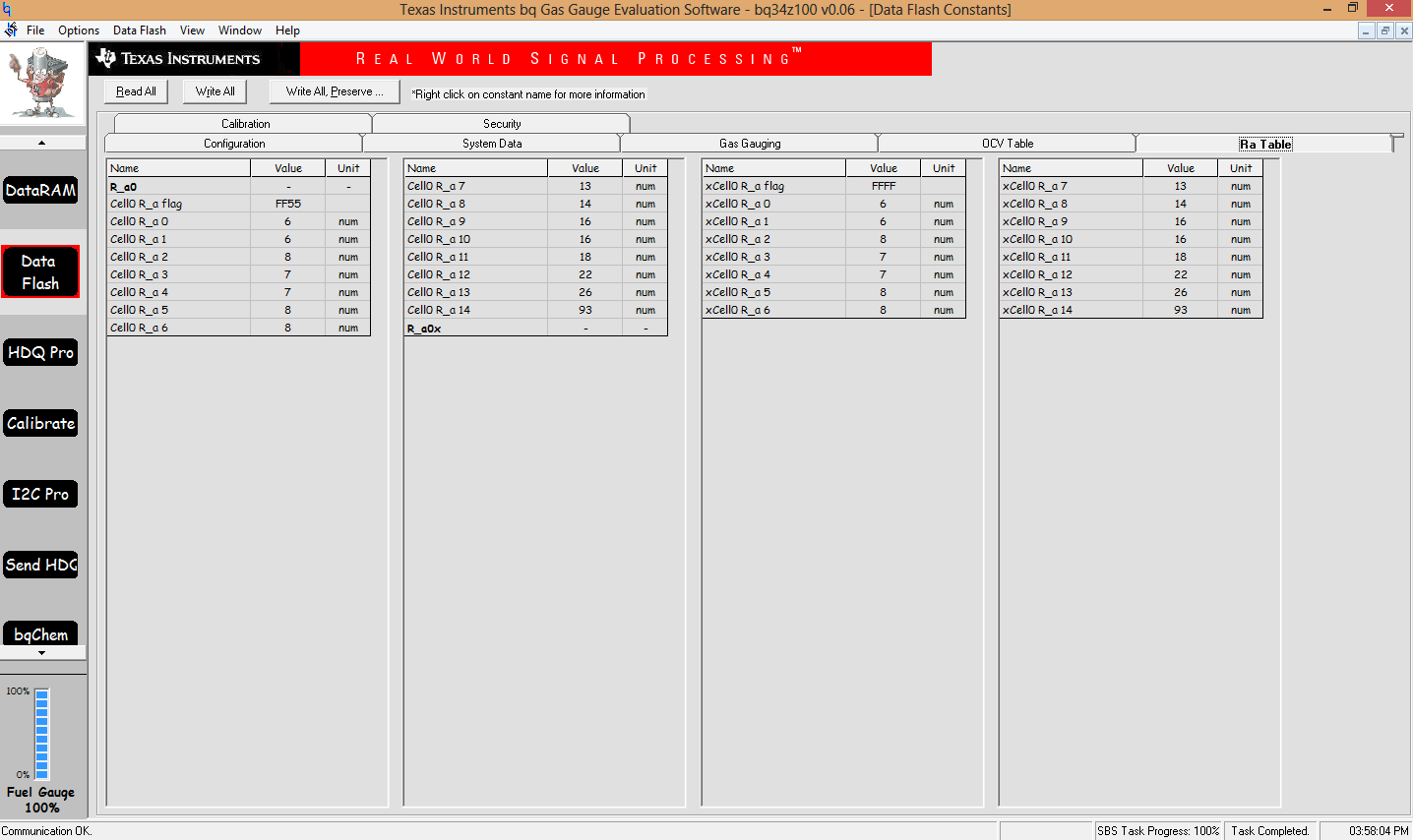

  • If your battery is fully discharged and the cell has rested for a few hours, then you can send the IT Enable command and charge it to full. Qmax should update during the rest period after charge. You can then discharge and the Ra table should update and Qmax should update again in the discharge rest period.

  • That should work. Note that you are using a LiFePO4 cells, so the rest period may be much longer after charge and discharge. I have seen it take 24 hours, but hopefully yours will be quicker.
  • Yes indeed it does look like it may take 24 hours for the discharged voltage to become stable. I'm at 17 hours and its still slowly creeping up.

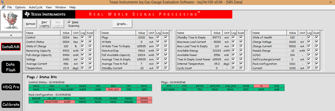

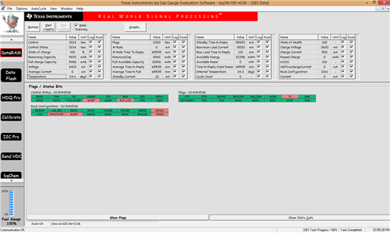

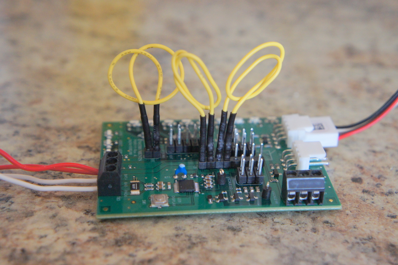

  • Is there any reason the CHG & DSG flags should be set at the same time?
    I noticed that the chip on the 2nd evaluation board got up to 75c as soon as I disconnected a load and then reconnected it.
    I saw that the CHG & DSG flags were set at the same time and figured that might indicate the reason the chip is heating up internally. Nothing else has been done that could have caused any damage to the board.
    I disconnected the battery from the chip and then reconnected it. It no longer heated up but the current is showing 0 but the CHG flag is still set even though the fuel gauge is in Sleep Mode. Is this normal?
    I did a control 41 reset command a few times but it does not clear the charging flag.
    I'm hooking up a small 2 amp DC Switching boost regulator that takes 3v and converts up to 5v DC. Do you think that maybe this device could be causing a voltage spike when disconnected or initially connected that could be damaging the IC?
  • Yes, it is common for the CHG flag to be set. It is defined differently on this device as compared to some of our other devices. It will be set whenever the pack is eligible to be charged.

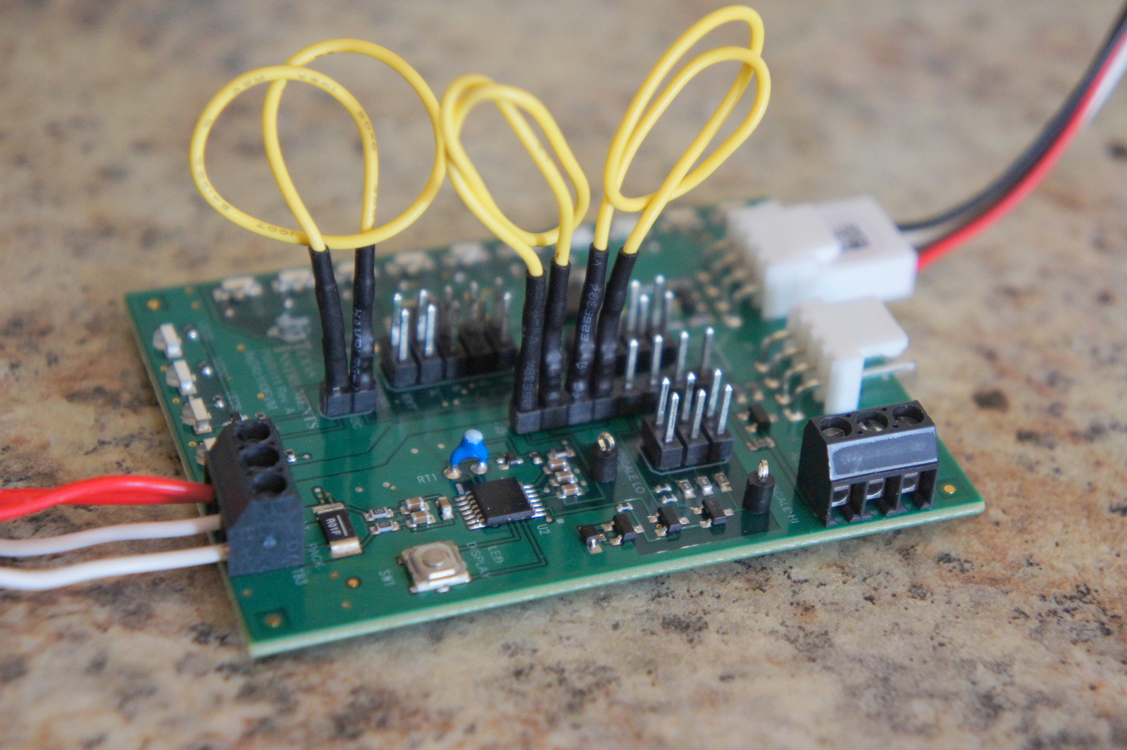

  • I have damaged these EVMs before by applying too much voltage to the BAT pin. In some cases the bq34z100 gets damaged and we have also seen the FET in the REGIN power path damaged. If you have a specific setup and procedure to induce the condition, then I can try it here. Also, please extract you senc file and I will use it.
  • So if I wanted to fix the first evaluation board I would need to just order a new Bz34z100 chip and what is the part number the FET that might possibly also be damaged? I'll order one of those also.
    I'm not sure how to get you to replicate the buck dc converter I'm using except to send you one of them. Everything else is pretty standard, just a 3.2 LIFePo4 battery and the EVAL board setup for a single cell monitoring.
    On the board that is still working, how could I tell if the FET was damaged?
  • Ryan,
    The FET is located in the REGIN power path and we used a 2N7002. You could use a similar FET that you may have available. It just forms a simple linear regulator.
