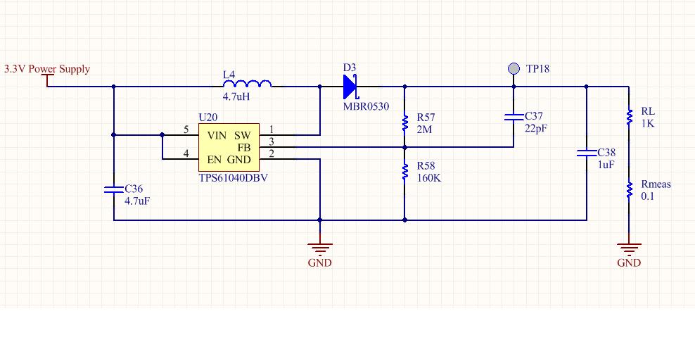

  • I change the boost configuration to one similar to Figure 16 on datasheet with the following values:
    L1    = 4.7uH
    Cin   =  4.7uF
    Cout = 1uF
    R1   = 2M
    R2   = 160k
    Cff = 22pF
    The load is 1k and there is a resistor of 0.1 ohms and 1% connected in series for current measure.
    The yellow graph correspond to the voltage on the 0.1 ohms resistor and the blue one to the feedback pin. The power supply indicates a current consumption of 77mA.
    Theorically the Iout max = 33,2 mA so for 1k (17mA) of load should work.
    On the FB there is an oscillation and the voltage remains bellow the threshold most of the time.
    Any clue what might be happening will help.

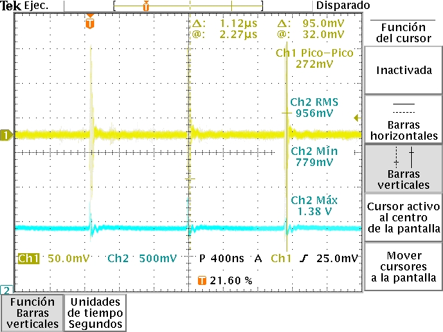

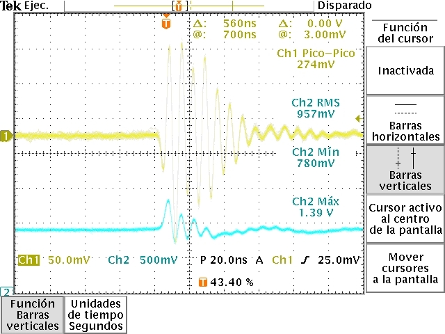

  • Thanks for your reply.
    Here  is the waveform on SW pin (yellow ) and the output signal (blue) for 1k of load:
    For 2.2k of load the signals are:
    Although the output voltage is stabilized to the load of 2k, power consumption remains very high (63mA). I like to understand what is causing this behavior.
    We are evaluating this chip for a  battery powered application. That is why the current consumption is our main concern.
  • since the chip works well with 2.2kohm ,it means your 1kohm load is too much for the device.You can use TPS61041.
