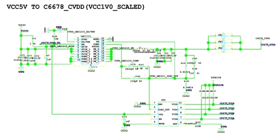

I used the LM21215A as the Buck with LM10011 as the programmable VID control device to be the power source of C6678 CVDD(SmartReflex) on my board . Our schematic shows bellow:
Here comes the problem : when the three beads  (FB1~FB3) arent connected , the output is 1.03vThen ,I connected them, I mean the C6678 becomes the real load , the output voltage drop to 0.92V, which can reluctantly make the C6678 finish the system reset, then we can link the board using XDS560 emulator, but when I try to load the test program to c6678 ,the CVDD dropped  to 0.7V fiercely, which makes C6678 cant work any more, because the CVDD power doesnt meet the requirement 0.9V to 1.1V.  I dont know how it comes. Is there any problem  with our schematic or the scheme LM21215+LM10011 isnt able to carry the load C6678?
