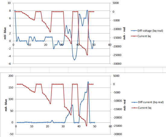

  • Hi Onyx,
    I use the bq20z65 with a 5mOhm as sense resistor.
    I'm currently testing the voltage and the current read from the bq20z65 and the real true one.
    So I've regularly decreased the load to increase the current with a few break during the process.
    The graphs below shows the result: (the right axe is for the red curve, the left one for the blue curve)
    We see that for the 1st graph the difference between the real voltage and the read one increases with the current (due to the heat I think). Is that normal ? At rest (no current) the difference is lower which is good but, is this difference low enough ?
    On the second graph, the difference of current increase with the current as soon as we go higher than 12A, I think it's due to the heat. Do you think it will works like that ? The bq20z65 will integrate a wrong current ?
    (For my use the bq20z65 will deliver about 14A with sometimes 35A during 10sec.)
    Thanks for your answer,
    Alex
  • Hi Alex,
    It would be preferable to compare apples to apples. It will make for easier interpretation of the data if you had converted the voltage to current and then compare the real values to the what's measured by the bq device.
    Measurement drifts of the coulomb counter is expected with increased temperature but ought not to be significant enough due to the precision of the ADCs used to affect SOC measurements. please refer to the data sheet of the device for questions on the specs on the temperature drift of the couloumb counter.
