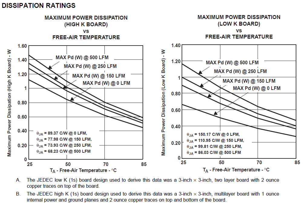

Where do i find the junction to ambient and junction to case thermal resistance for BQ24702?
Kwan
