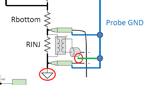

Would you mind if we ask the method of  the measuring phase margin on LM1117?
In order to measure the phase margin, the resistor to inject small signal is inserted between R2 and GND
as following attached file.
6433.Attached file.pdf
<Q1>
Is this the method true as the measurement of LM1117-ADJ's phase margin?
<Q2>
In general, we think that the correct method(way) is following;
Method : The resistor to inject small signal is inserted between Vout and R1.
If you have any advice, could you tell us?
