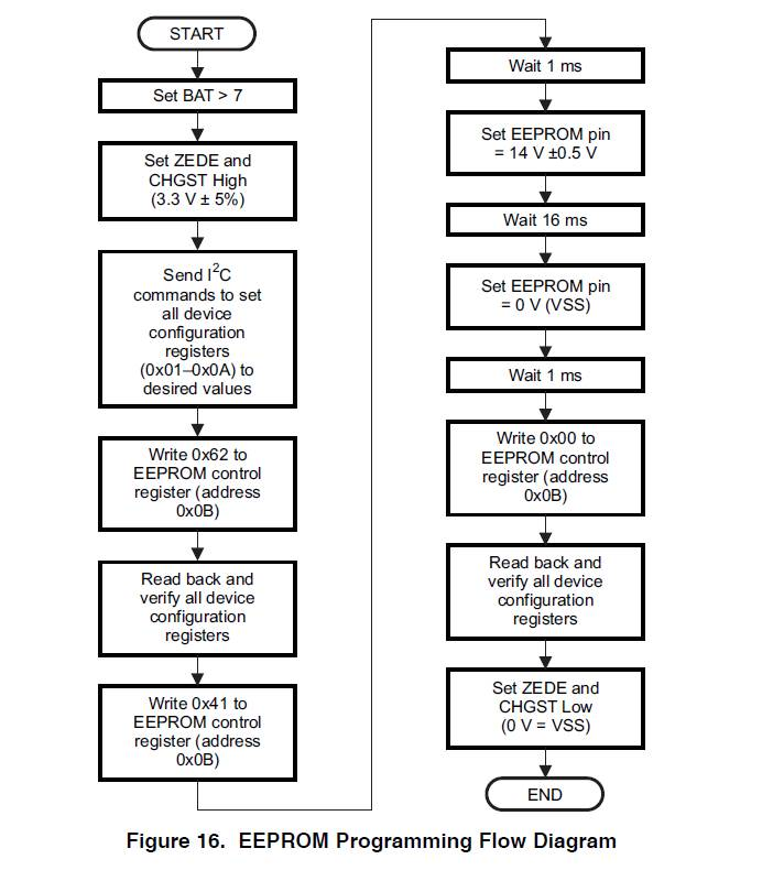

We are using BQ77910 for Protection in one of our projects.
My main query is related to programming/writing the data to EEPROM from the microcontroller.

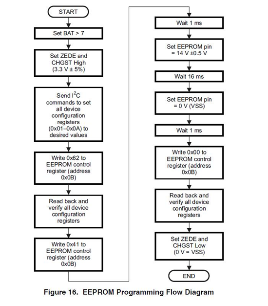

I followed this flowchart and wrote the code exactly as the flowchart below.
In the below Flowchart, We are reading the data registers for verification 2 times, When i read for the first time i am getting all 10 Bytes of data (with only FIRST Byte missing).
in the second Verification (reading data) I get all random data.
If i reset and read the data, its all 0xFF
The following is the code i am using:

  • Anyone ?
    Please help me, i am running out of time and have been trying this for 2 days without any improvement.
  • I don't recognize a problem in the code.  if you are reading all FF after reset, it seems you must be initiating the programming. Suggestions:
    Be sure the ground path is good between the microcontroller and bq77910A boards.
    Be sure all IC pins are properly connected, particularly the VSSn, GND, BAT, VREG and the control signals used for programming.  Be sure the VREG capacitor is present
    Look at the I2C signals with an oscilloscope to verify the clock rate is staying < 50kHz and that the device is acking.  Be sure the signals have good edges and levels at the board/IC.
    Be sure CHGST stays high during the process and ZEDE stays high during the communication.
    Be sure the power supply voltage stays high and VREG stays on and stable during the process.
    Be sure the EEPROM voltage goes and stays high (14 +/- 0.5V) during the commanded time and is low (~ 0V)otherwise.
    None of the conditions you describe seem normal: the missing byte on the first read, the random data or the all FF.
    Try a different part. The part may have been damaged by the unsuccessful attempts, you may need to replace the device.  You might try a much lower I2C clock to see if the results are different.
    If you have the TI EVM and programming adapter, you might make comparative measurements with a scope.  Be aware though that the TI evaluation software may not follow the flowchart exactly.  For example it toggles ZEDE with each communication rather than holding it low for the process.  It also may not read back the data after it is first written.
  • Thank you very much for a very detailed response.
    That was very helpful.
    This happens to be the problem. I checked with the scope if the EEPROM Signal was going High or not, But i didnt check the Voltage level at the BQ side. Now that i have verified, I notice that the Signal on the BQ side is not toggling.
    Corrected now and working as expected.
