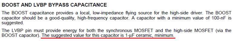

I'd like to ask about the recommended value of LVBP bypass capacitor.
I found the following description in datasheet P.12.
On the other hand, I also found following in datasheet P.20.
Which value is recommended? Is it possible to use 0.1uF?
