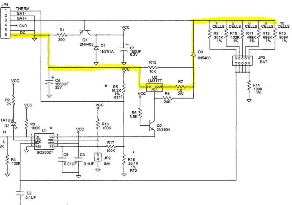

The only schematic I could find is the schematic that is shown in the http://www.ti.com/lit/ug/sluu007b/sluu007b.pdf pdf file.  My question is what is the purpose of Q2.  It seems that all the current will go through the chip anyway and the transistor is on continuously.  Do you have another reference document that shows the proper connection for this chip.

    The charging current is passing as follows through the system.
    The purpose of the Q2 is to turn the regulator LM317 on and off by being High-Z or open sink.
    Here is a post on a different forum that showing a different users approach to using this part that clears up the role that Q2 plays.

    I have a BQ2002 in a board using a LM1117.  The voltage drop across the device and diode is not allowing the voltage to rise above 3.1 so the cells only get 1.5 volts per cell at full charge.
    I have seen a device using the BQ2002 and it is using a ldo regulator charging at 250 ma.  I cannot identify the regulator it is a SOT23 5 terminal device with a 3.0 ohm resister as the current limit.  The marking on the device is A10B.
    Do you know of an .3 LDO regulator that I can substitute for the LM1117.  Thanks

    What is the flow of power? What is the input voltage and then what is the arrangement of the devices (Input, bq2002, lm1117, battery, load)?
    As you outlined in the first response.  The flow is the yellow line.  The input voltage is USB power 5 volts.  I set the current to 250ma  which is C/4 for two 1000ma AAA batteries.  I currently have the full charge set to 3.0 volts with a 180K and 350 K to ground going to the bat pin 3.  The voltage does not get high enough to stop the charge.

    The application note showed the lm117 and the 1117 acts the same but it still drops too much voltage.  I know it can be done because I have a device charging at 250ma with the usb.

    You might be running out of voltage overhead. The forward dropout voltage of the LDO combined with the current setting of R7 might be causing this issue.

  • The key is to find a LDO that has a lower dropout voltage. The goal will be select a LDO that has a Vdo of less than 1000mV
