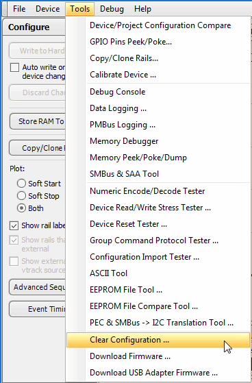

  • In the Fusion Digital Power Designer GUI: Clear Configuration from Tools dropdown

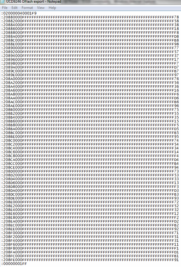

    JTAG: Write a DFlash configuration with all bytes set to 0xFF.

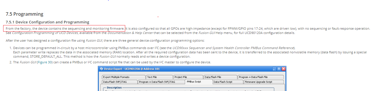

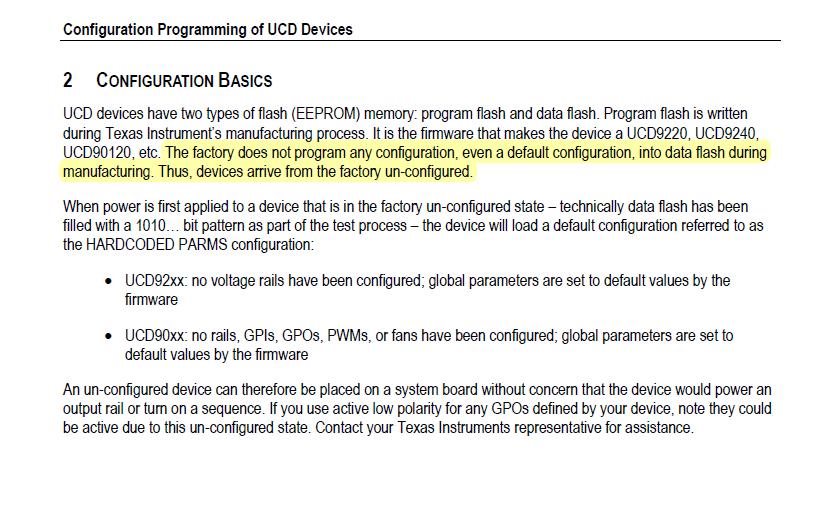

    There are two different statements regarding the factory configuration for UCD90120A  as shown in below images.
    Please clarify if there is any default firmware configured for a particular sequence.
