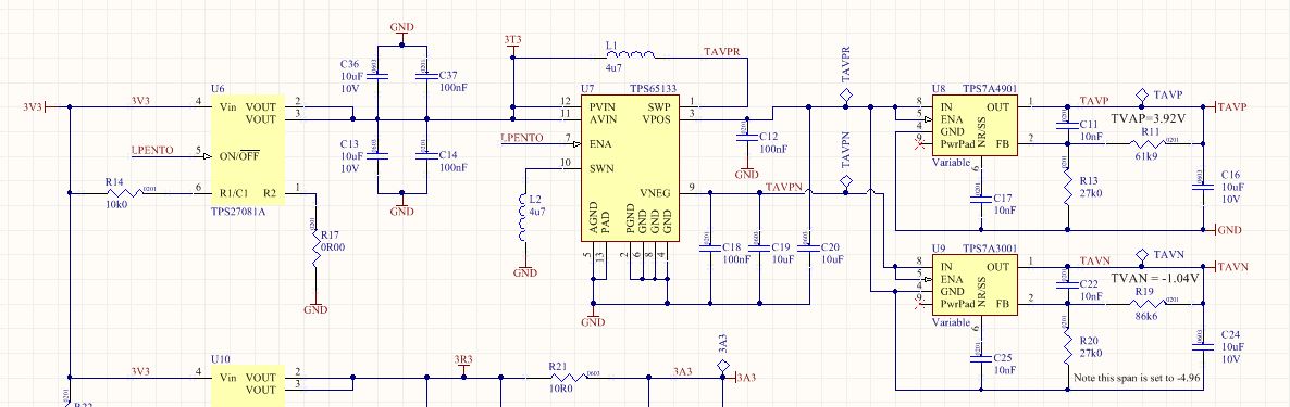

 I have a customer who described the following issues on TPS65133:
Problem: No negative rail developed at all.... does not even seem to try to start the SMPS.
+5V rail = fine, starts up.
Supply - both per circuit attached, and we did jumper leads to a lab linear 3V3 supply direct to part.
Diagnostics:
Part number on device confirmed to data sheet (so we have the right part) Inductors changed out from ferrite to iron core/lower DCR Caps (big/lowDCR) added everywhere Earth couplings changed to look like a copper mine between Cin, Cout, Inductor rear end.
Load taken off, down stream regulators taken out, Finger waggling (yup) and a stern telling off.....
No joy - no Vneg what so ever, not a sniff.
This is happening on more than one board - three exactly the same so far.
Any ideas what to try next?
